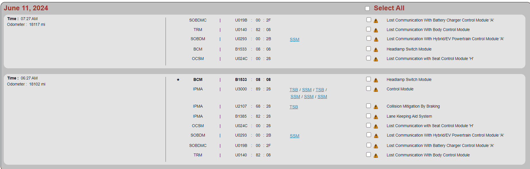

Vehicle history shows a PMI of the SOBDM was done today around noon. At 6:39 pm, it reported this code to the cloud:
The TSB associated with that code asks them to update the BCCM which they have not done yet. It is unclear why the PMI'd the SOBDM. The truck was sitting untouched for a while until today. I assume they opened a case with engineering and were told to do what they did? Hard to tell. As hard as it may be, I would just be patient and let them do their thing.

Everything looks good to me in terms of updates. Hardly anything pending other than a BCM. Seems like this truck was blessed with FDRS recently.
I see it threw come codes on 6/1. It is intermittently recording some codes in relation to driver assist features in the IPMA. Is the truck having any issues?
Ford F-150 Lightning PTS/FDRS VIN Check Thread 1718669967108-ci
Of the SSM's and TSB's referenced there, attached are the ones I think are relevant. Could be a loose connection; it could be a bad battery. It you are having issues, I would reset the IPMA with FORScan and see if that cleans things up. If not, a dealer visit may be warranted.
Thanks for the info. I did end up replacing the battery a few weeks ago and doing FDRS update. I’ll reset the IPMA as well. My biggest complaint is still the lack of 6.3 update for the Apple Maps battery %.

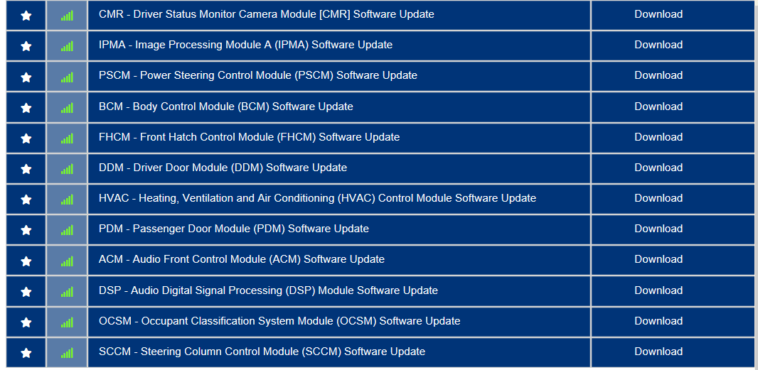

Good evening. When you have a free moment if you could check my vin I would appreciate it. I’m looking for required module updates I might be missing to update/activate BC 1.4
1FTVW1EV0PWG37850
You'd need the CMR, IPMA/PSCM and SCCM. The IPMA/PSCM are only available with FDRS.
