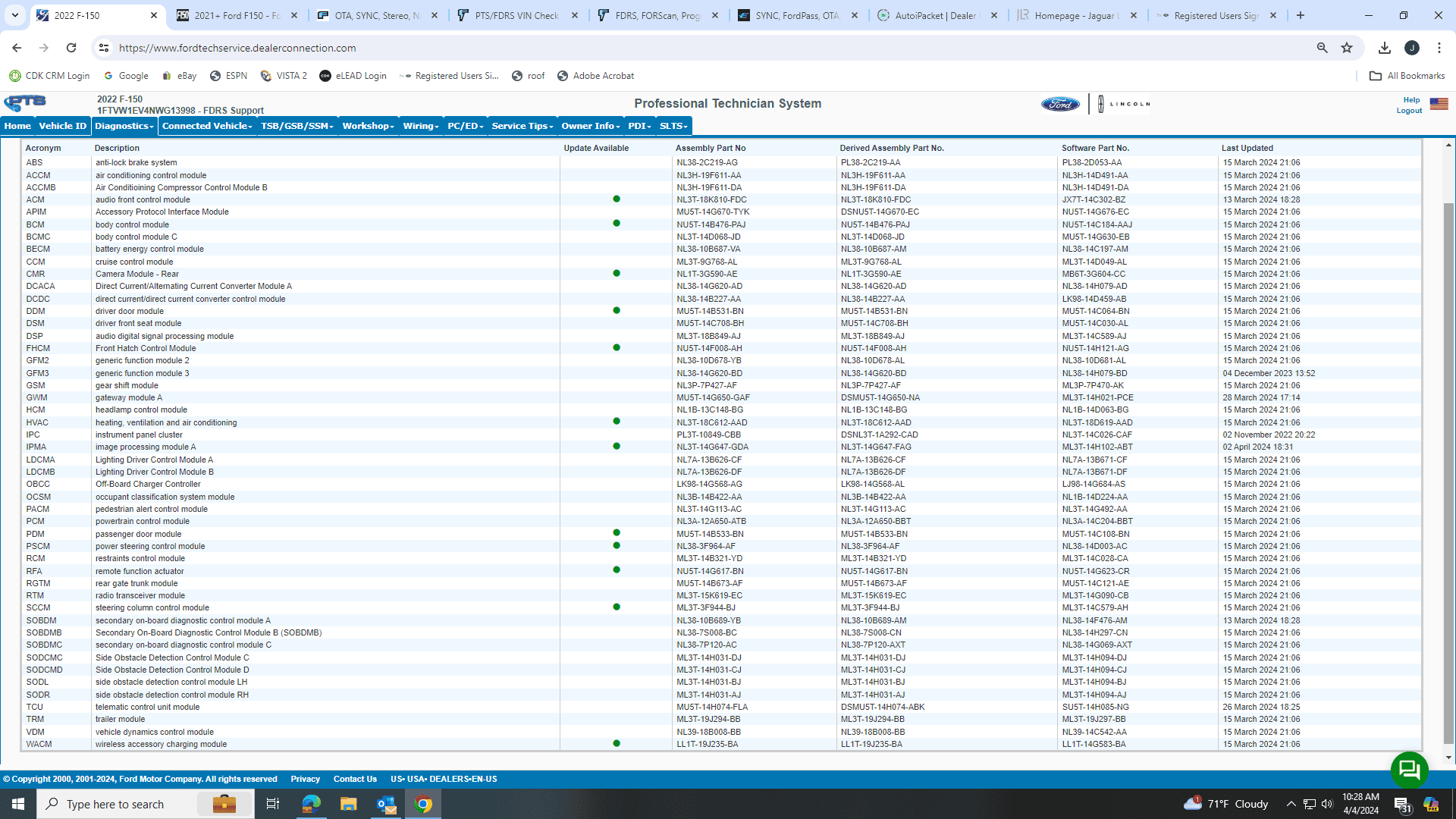

Like a few others, you got 4.2.1.1 and 4.2.1.2 last month. Nothing in queue at this time and this is what have showing pending.
Last power-up update you got was 6.4.0 followed buy the Tesla charger update two weeks ago. List of pending updates is below.

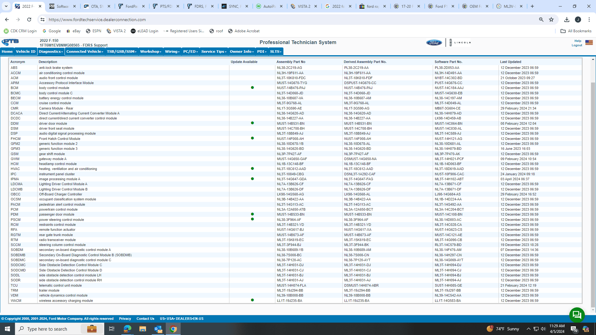

I see 6.1.0 went through a week ago. Modules pending updates are below, but FDRS may show a few more. I will never try to talk anyone out of getting a Mongoose. Notable things you will get with these updates is the battery level on the IPC, much improved bluecruise and/or dirver assist features, the Tesla charger update and more.

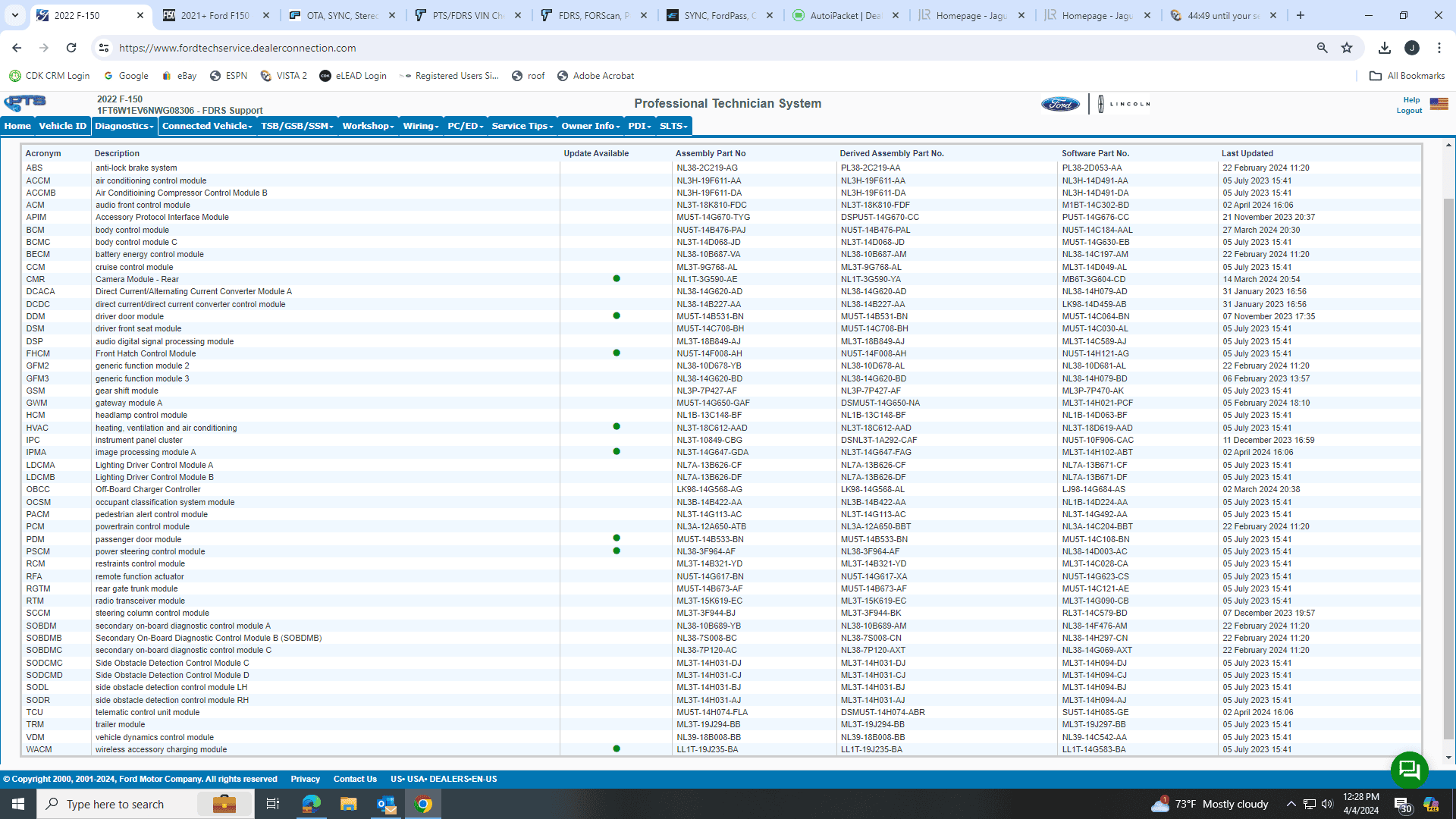

Last OYTA you got was 4.2.1.2 a few days ago. Pending updates are below:

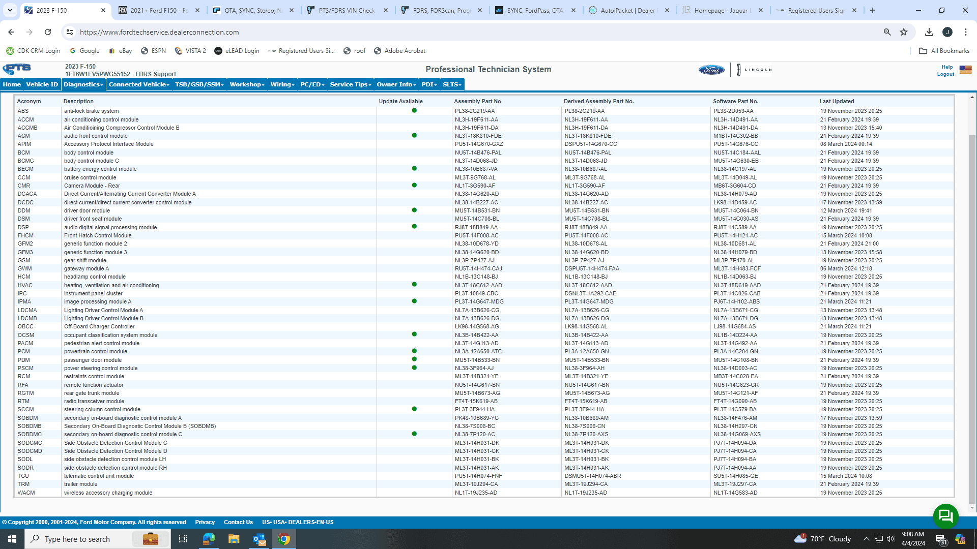

Unfortunately for you, the update that failed on 3/29 is the CMR-FX update which would have fixed your broken Bluecruise. It failed to a write error to the module; nothing you did wrong or could have done differently. You just have to wait for it to be resent. Modules pending updates are below:

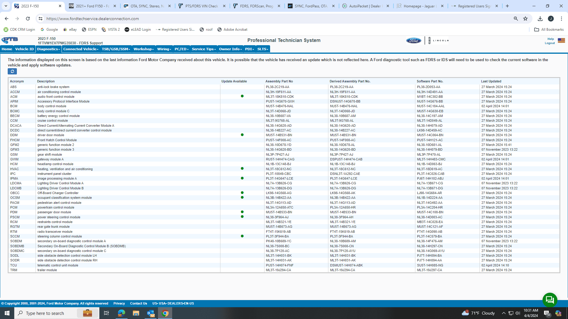

Seems like you've gotten most of the OTA's. You had OTA 23-PU0813-DOR-UP2 for the door modules fail on 3/19, but that was due to a server hash issue on Ford's side. You only have a few modules pending updates.
