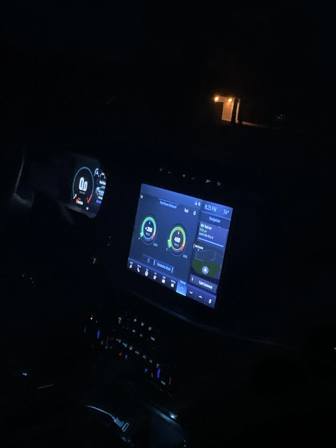

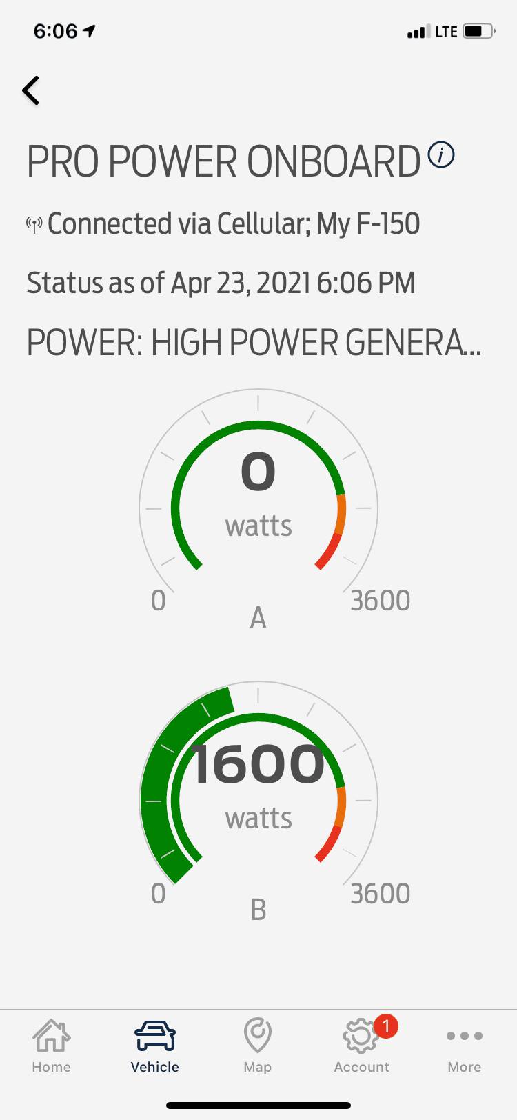

4 -both lcds stay on the whole time...you can dim accordingly I’m guessing...a few pics below
5 - the Bambi has one dometic AC rated at 13500 BTU. When the compressor kicks in the propower display shows its using 1500- watts on circuit B
6 - about 30mins into using propower it cutoff and said power exceeded...nothing else on except AC and fridge. When I went to turn it back on it kept saying power exceeded. So I turned off AC and started all over...4 hrs later no issues...not sure if the dometic sometimes draws that much to exceed the 3.6Kw...but could happen I guess...I could install and easy start but not sure I want to mess with it since the Bambi is fairly new.
