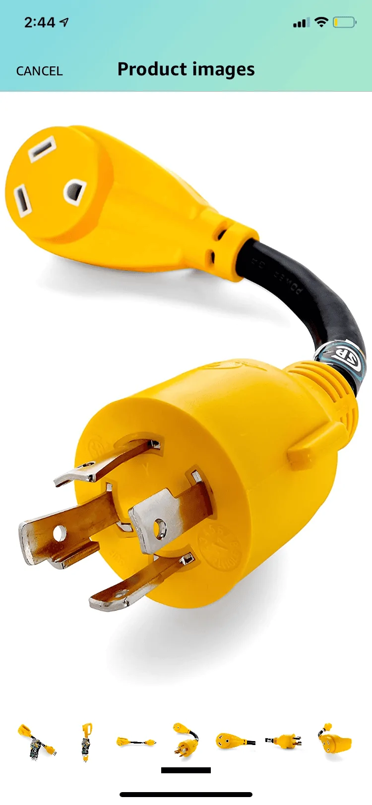

Anyone have feedback on this (or similar) adaptor? This is exactly what I have in mind for an upcoming camper rental. Hoping to hear positive things. Since it's a rental I won't know it works until...it works. The plan "B" is to adapt into the 120V-20A outlets like OP did but would rather get it right on the first try :cool: .

This is the same adapter I have and that I have used once so far. It worked without issue to power my 30 amp Winnebago 2100BH with lights, TV/Connex, refrigerator, 15,000 btu ac and the microwave. It pulled about 3100 watts from the 240V outlet with all these things running. After turning off the microwave, I ran the ac and other things for a little over an hour in 85 degree heat to test it. Our first overnight trip will be in a few weeks, so I will report back, but I am optimistic after this initial test.

I have used a similar adaptor to run my Escape camping trailer from the 240 outlet. It draws from circuit B. In general it worked fine, with it on about 4-6 hours per day. The truck was pretty quiet, but I still liked to turn it off during quiet times. I used less than a quarter tank over 3 days of partial use (sorry no accurate measurement yet).
I had a problem with overdraw which caused an error message on the center screen (same as shown in this thread) with a reset touch button. I think my battery charger and refrigerator and water pump were all operating. I reset it and it worked after I turned the refrigerator to gas mode.
I would like to know how much current draw causes this software reset.
