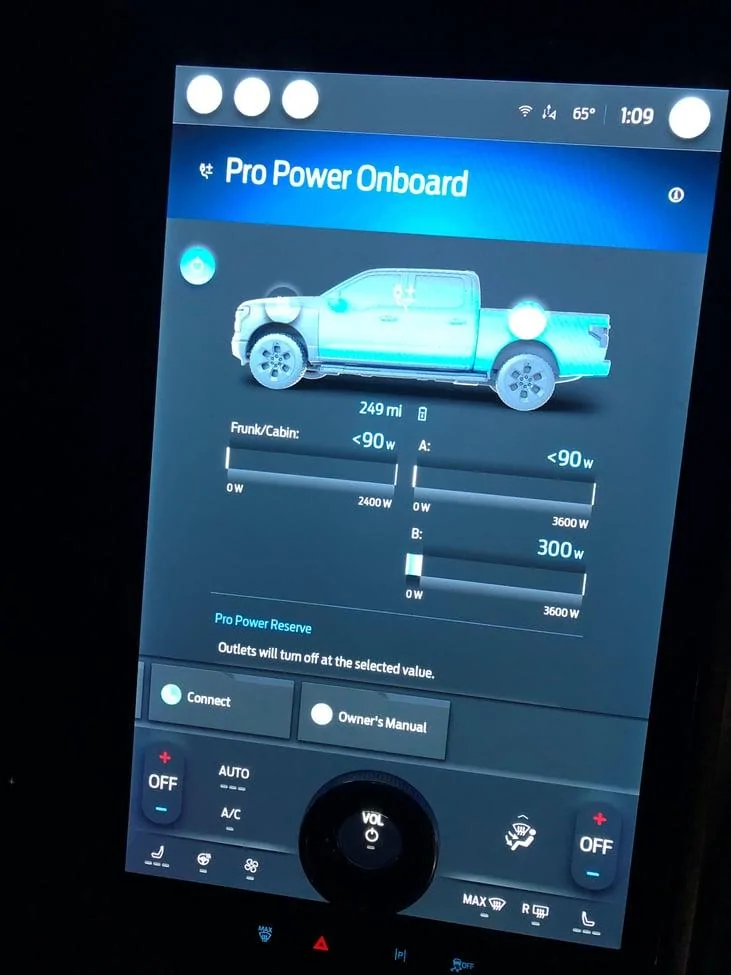

During a wind storm last night at 11:16 pm we lost power while at our remote cabin property. I was able to connect my trucks 240v 30 amp output in the bed to my generator inlet that I had installed a few weeks ago. About a month ago I installed a generator interlock kit and generator inlet at the main panel so I can totally disconnect from the grid and power the cabin with a generator. I already had a 30 amp 240V very long custom built cable that I built after the 2005 Hurricane Wilma when we lost power for almost 2 weeks at our previous house.

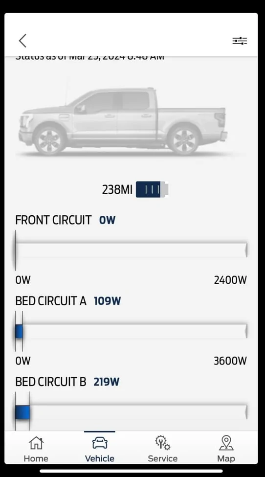

So last night I turned off all the 240v breakers except for the house water pump from storage tank. So I still had the refrigerator, freezer, internet modem, computers, cell phone chargers CPAP machines, all lights, ceiling fans tvs all working and we are drawing a total of 300-360 watts.
Initially had problem where the truck was turning off after about 25 minutes until I realized I needed to keep the ProPower display up in the screen. I went to sleep at about 1AM with Lightning powering the house. When I woke up at 8:30am In 8 hours I had only lost 16 miles of range in the truck. Went from 254 to 238miles of range. I’m very impressed.
