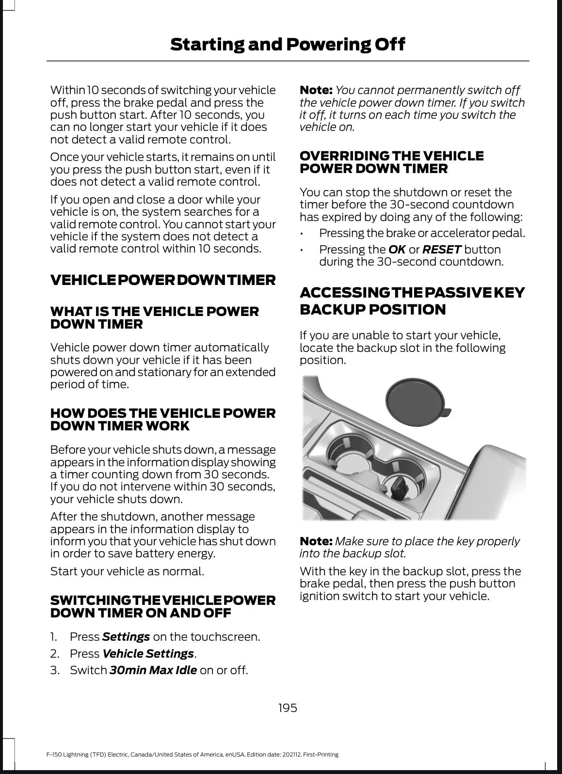

I saw your post on FTE, but you included more detail over here. Did you turn off the 30-minute shutdown timer? I haven’t heard of PPO shutting off when the screen isn’t up, but the auto shutdown is always enabled at every ignition cycle unless you shut it off with ForScan.
No, The remedy to not have the truck shut down was to leave the ProPower screen up after starting the truck and selecting the 240v output. I also turned off the truck's AC. It ran all night (9 hours continuous) without shutting down.
If I exited the ProPower screen with CLOSE Selection the ProPower would continue to operate but the truck would eventually shut down and ProPower shut down at about 25 minutes.
There’s a switch to turn that off.
