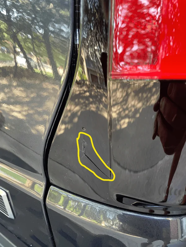

Double-check you don't have a small crack.My passenger side had one, not sure what I hit or when (or if it was me). Bought a replacement off eBay.
