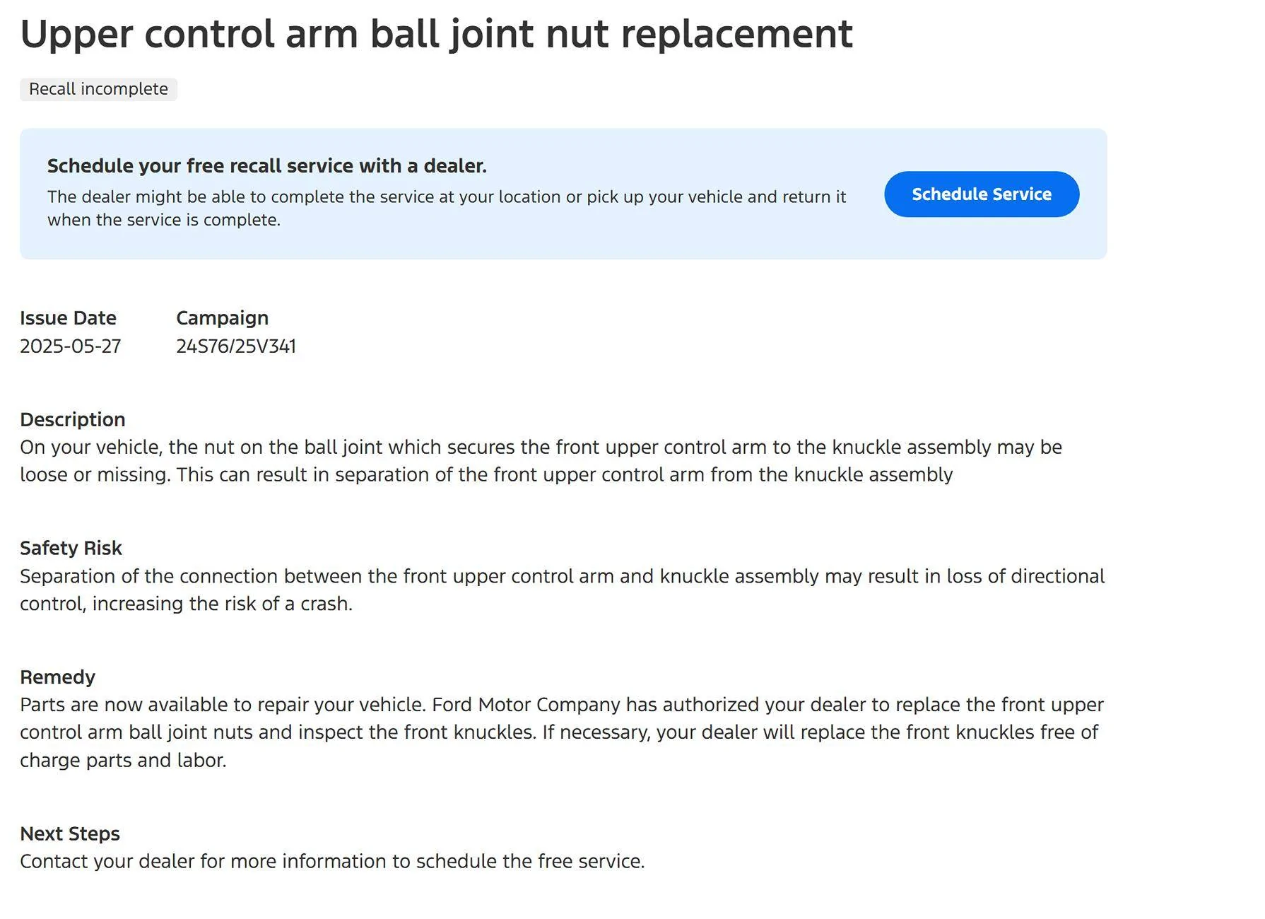

The recall is changing the nut with different nut and torque it appropriately.

has anyone got this recall for Ball Joints NUTS missing are not tighten? When I got it I call dealership, and they said they had to wait on parts, will schedule when they come in. First Ball joint nuts is a hard-to-get item and anyone know if it safe to drive?
Got ours last week. Have it scheduled for service this coming Monday.

The Ford service representative at the the drop off point of Dealership service said to me they had "checked, tightened and torqued the nuts". "No new parts necessary", he said. Maybe accurate as to exactly what they did, maybe not. Maybe accurate as to the dictum of the recall, which may require new nuts regardless. Maybe not. No way to know for sure, except he said I was good to go. They gave me a pat on the back and sent me on my way. Hopefully, things we're done exactly as required.

Truck returned to my home exactly 4 hours later.
"Replaced driver and passenger upper ball joint fasteners"
Other than having to turn one pedal back on and move my seat and mirrors back to my normal position, this was a surprisingly truly painless experience. I hope this is a sign of better things to come for my local dealer and Ford in general.

Yup. Took mine in last weekend. They replaced both sides and had me out in a few hours.

Same, dropped truck off at 7 this morning and picked it up at 10. Invoice says they replaced 2 *W717969*S440 Nuts. Quick and easy...

I got the recall last fall. There is not a dealership in Juneau, AK, nearest dealership is in Whitehorse, Yukon, CA. I didn't want to drive it up to Whitehorse thru the pass in the winter, I waited until May. The nuts were tight, but not up to the proper torque, 25.8 FTLBS. They replaced the nuts with new nuts and torqued them properly, 46 FTLBS.. They had me drive it a day and return to have the lug nuts retorqued as they had to remove the front wheels to do the service. I did do a visual inspection last fall when I got the recall notice, and the nuts were on and appeared to be tight to the feel. Very happy with the service at the Ford dealership in Whitehorse.
