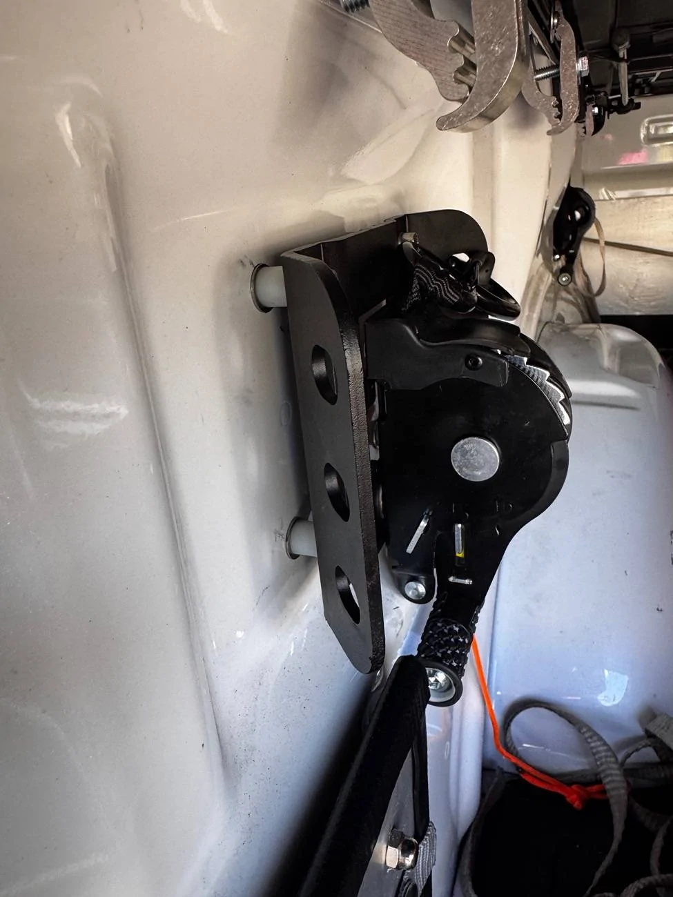

I have had two mounted on the left side for several months
https://a.co/d/cSBDNcX
They functioned great straight up and down. They did not twist at an angle because the bottom of the ratchet assembly rubbed against the bed wall. I solved the problem with longer bolts and spacers between the bed wall and the ratchet strap mount. Hopefully other models don’t have this issue.
Ford F-150 Lightning Retractable ratchet straps seem like an amazing idea, anyone tried them? IMG_8519
