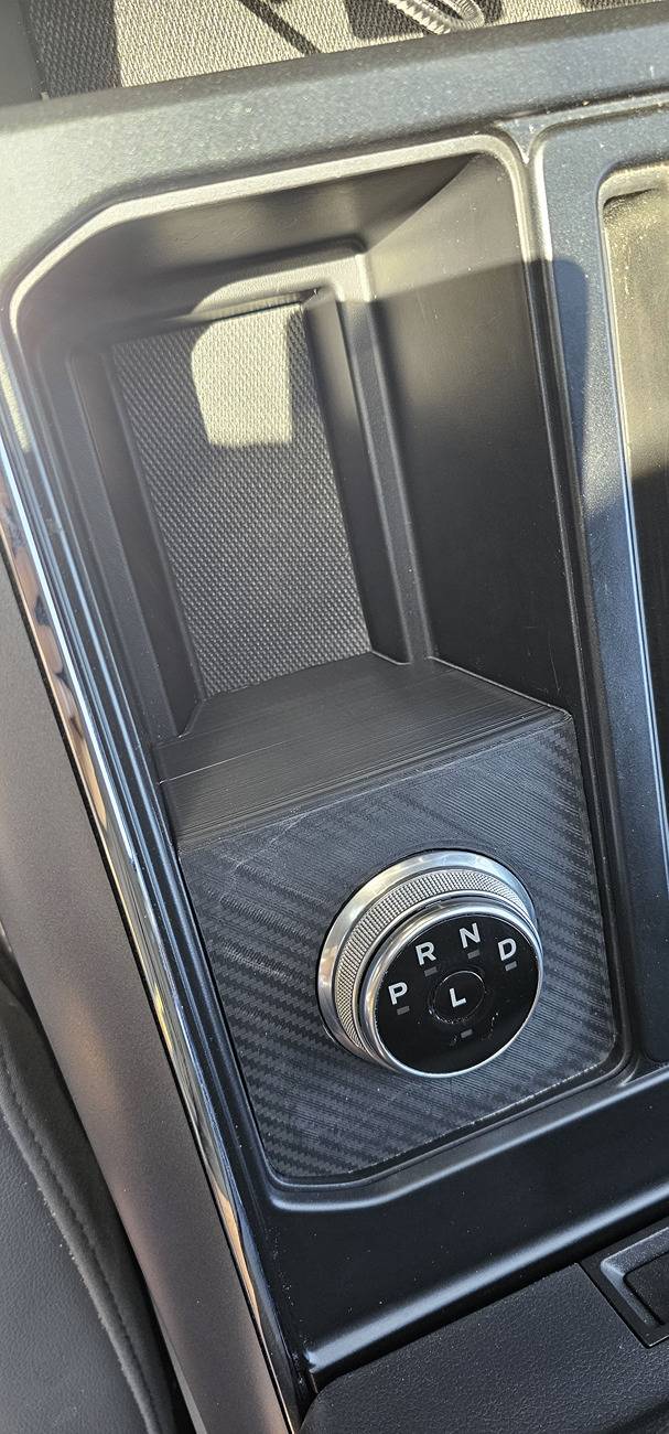

I have seen others use the ICE F150 center console left side rectangle box for a rotary shifter by cutting a hole in it for the harness to pass through and then 3D print a "top hat" to hold the rotary shifter. I like this option because it's easy to pull up the shifter and unplug it if needed
I did actually consider this so that I could change gears without lifting up my "center dining table". The rotary under it is nice, but it still annoying that I have to lift the console cover to get to it. Ford always claims their vehicles are tested by "real users" before they are released, but I could cite a metric sht ton of feeble design choices that could have been done better. Why not just put a rotary shifter on the dash, and let the console work table be down in drive if people want or need that?
Do you know if anyone posted pics of the "side mount" option.. is it on this forum? I remember searching for it but couldn't find anything relevant.
Ford F-150 Lightning Rotary Shifter Upgrade 98731-9bfe786f1cfa989fb60a634ce505542b
This user has a few posts in this thread showing this concept:
https://www.f150lightningforum.com/...inted-rotary-shifter-holder.25541/post-505134
https://www.f150lightningforum.com/...inted-rotary-shifter-holder.25541/post-501808
