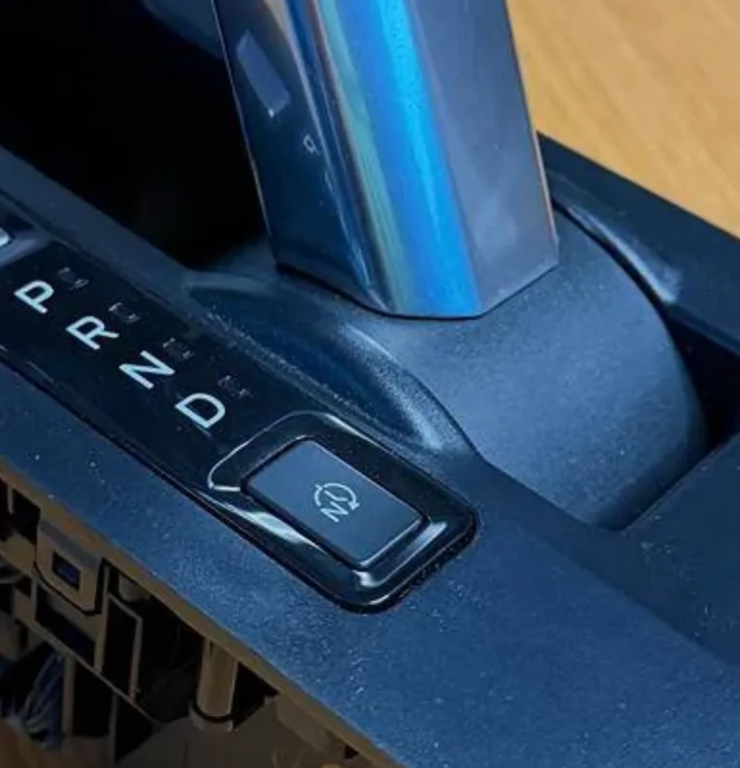

It activates the 30 minute emergency neutral. It's the same function as the button with the circle arrow and "N" on the center console of the original gearshift.

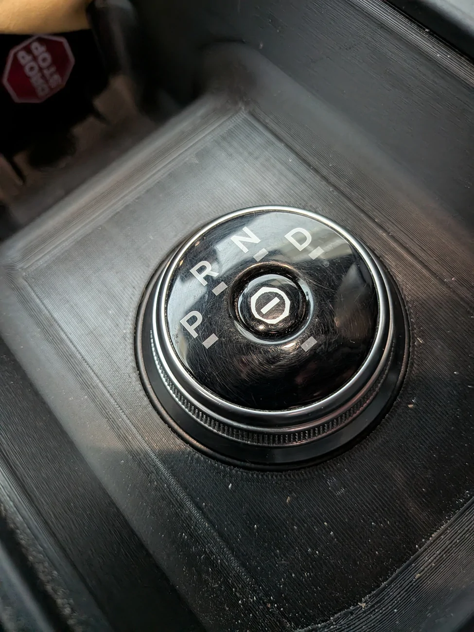

I tried to find some cool symbol in my label maker to put on the middle button instead of the L or M (I forget which I actually have). The "Do not enter" ⛔ symbol was the best I could come up with.
