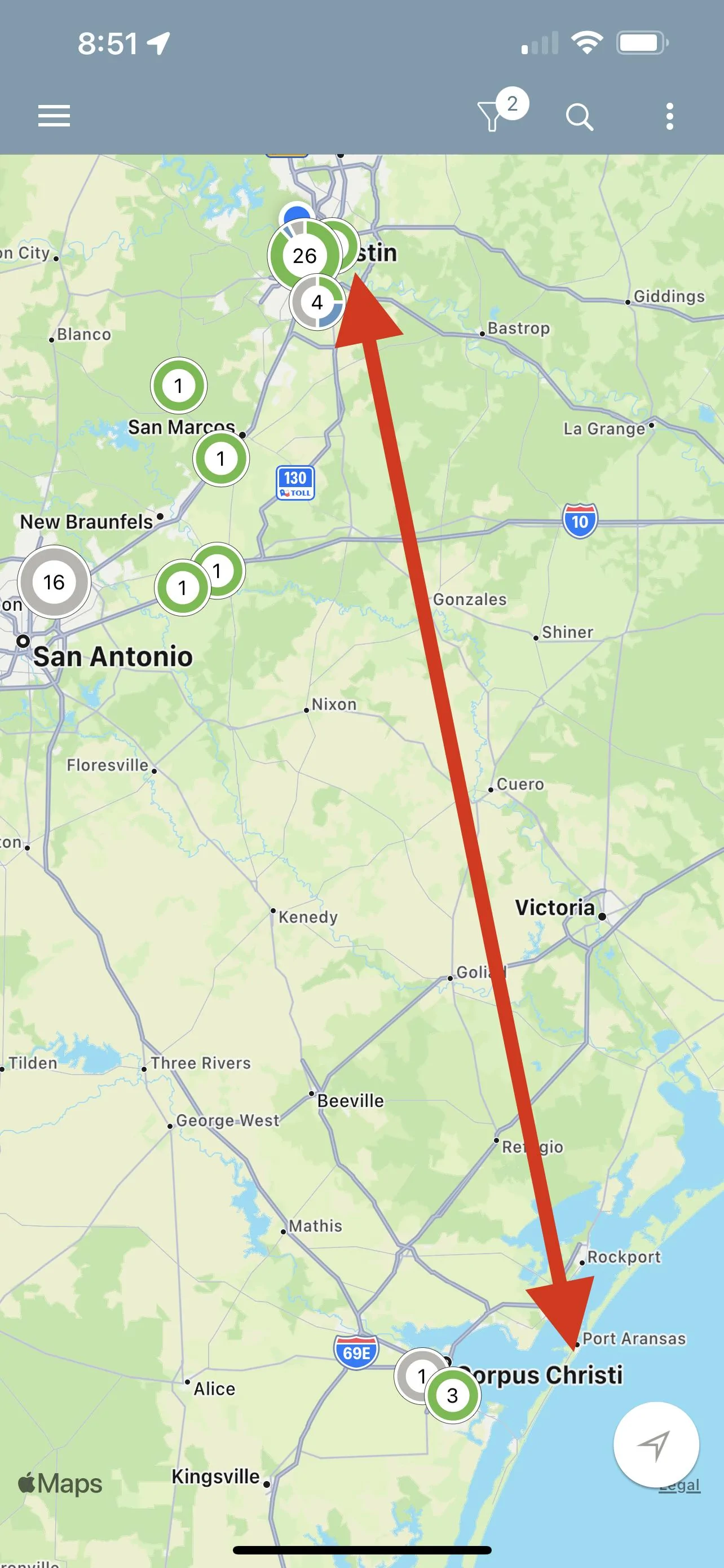

It's all good on paper, but it's when it doesn't go good that you're actually concerned about. So a couple of questions.
1) How familiar are you with EVs in general? Not necessarily long haul but if you've driven an EV for 5 years vs just had it for 5 weeks, that makes a difference.
2) How familiar are you with the F-150L? Especially when you need to find miles.
For example, in my Tesla Model S I have a good general sense that my consumption is running higher or lower than my normal. So I can get a pretty early sense as to - I may end up in trouble or that charging. top won't work if I don't do something now. I know to start switching HVAC off, slow down by 5mph, etc.
If you feel like you can do #2 especially, no issues go for it. If not, I would get comfortable with #2 before I took a long trip. It's not bad to do, but it's a lot less stressful when you can anticipate instead of scramble.
The F150L is my first EV, and I took delivery three weeks ago tomorrow.
So this will be my maiden long distance trip, and through a charging desert, >100 degrees, with toddlers in the car - collectively exactly why I’m ā€œthinking twice, then thinking again.ā€
I should note: on this trip I am more than happy to set cruise control at 60mph to begin, and then roll down to 55mph if necessary

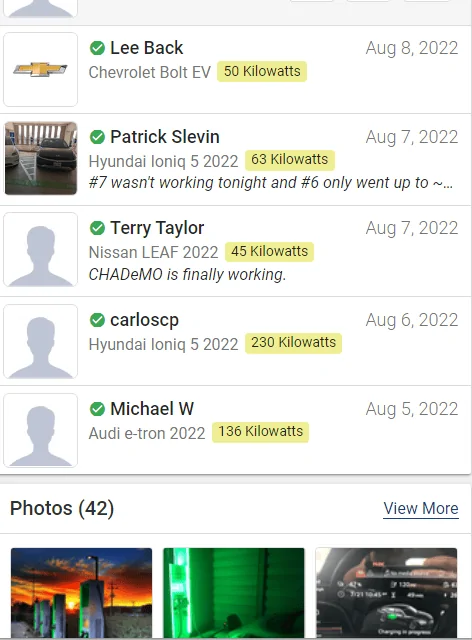

Oh, I get it! I don't feel that same confidence in my Lightning yet, because I find that 25-30% of EA stations have some sort of a problem, or they have a line when I arrive (and since they're typically at Wal-Mart in these parts, many/most have gone in to do some shopping). But, you'll get more comfortable and familiar as you progress, and knowing that you have options is a good thing. I've carried around Tesla's $500 ChaDeMo adapter for well over 5 years now "just in case", and I've used it all of maybe 3-4 times for charging, 5-10 if you count testing it? Knowing you have options with J1772 and campgrounds provide some peace of mind, even if you don't exercise it.
And maybe the continued $1B per year investment by the federal government in charging networks will give us an equivalent to the supercharger network (in quality and coverage) by 2026.

The truck has a low voltage and that charger looks to be amp limited 62.5 unit. You could easily see 40-50 kw type charge speeds. You may not actually not see any time savings going to that seguin unit vs the EA. At about 65%-70% on the EA you will get 170+ kw on the burst charge to 80% At EA. Then 15 minutes from 80% to 90% at 60kw. Done in 20 minutes on EA vs ~ 1 hour + on the other one.
Also activate your plug and charge before you go. You will love it when you use it esp. as it is free.

Snug in the beach house, with a comfortable (if conservative) passage through the charging desert!
• Began trip with 100% charge from Austin at 10:53AM, 91° ambient with climate set to 75°; GoM estimated 294mi range (based on my previously all around-town driving)
• Drove 78.5 miles with a dash-purported 2.7mi/kWh, arriving at San Antonio EA fast charger with 80% battery
• Charged to 100% in 57mins (the first 20 had the truck/climate running while we ate), with 28.613kWh eaten by the truck (corroborating the 2.7mi/kWh dashboard figure), GoM now
Estimating 305mi range; emboldened, set cruise to ~70mph and cabin climate to 72°
• Drove 178 miles (including through a windy thunder storm) with a dash-purported 2.1mi/kWh, arriving at Port A beach house with with GoM estimated 94mi of range remaining
• In all, 256mi at a dash-purported combined average of 2.3mi/kWh
