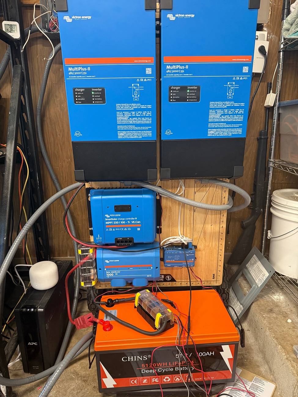

Ford F-150 Lightning Setting preferred charge times ? IMG_0284
In general, I only want to charge when the sun is out, (and it did let me set weekends to 11am-5pm, which is what Iโ€™d like to set weekdays to as well) we charge at 12 amps, which leaves the Victron system enough headroom to also run the garage mini-split. It maxes out at around 4.5-4.8 kW. This is all testing for a mobile system that weโ€™ll have in a Car carrier/camper. Itโ€™s all mounted to a Hand truck, with a single 48v, 5kw lifepo4 battery. Iโ€™m just wiring in the non-mobile, 10kW bank this weekend.
Eventually, weโ€™d like to get to charging the Lightning, while using the Pro-Power to power the Camper. So far, the system works as designed, but would be more fault-proof if Fordโ€™s app worked a little more of the time.

I don't understand why you can't program the weekday time parameters.
12 amps at 120 volts using the Lightnings FMC?
Is there limited cell data in the area you're parked for the telematics modem to work reliably?
BTW, delete any departure time events, if you have any that might confound the functionality of charging routines, more a problem in cold climates when the truck draws energy to warm the battery. Not likely an issue for Austin TX.
