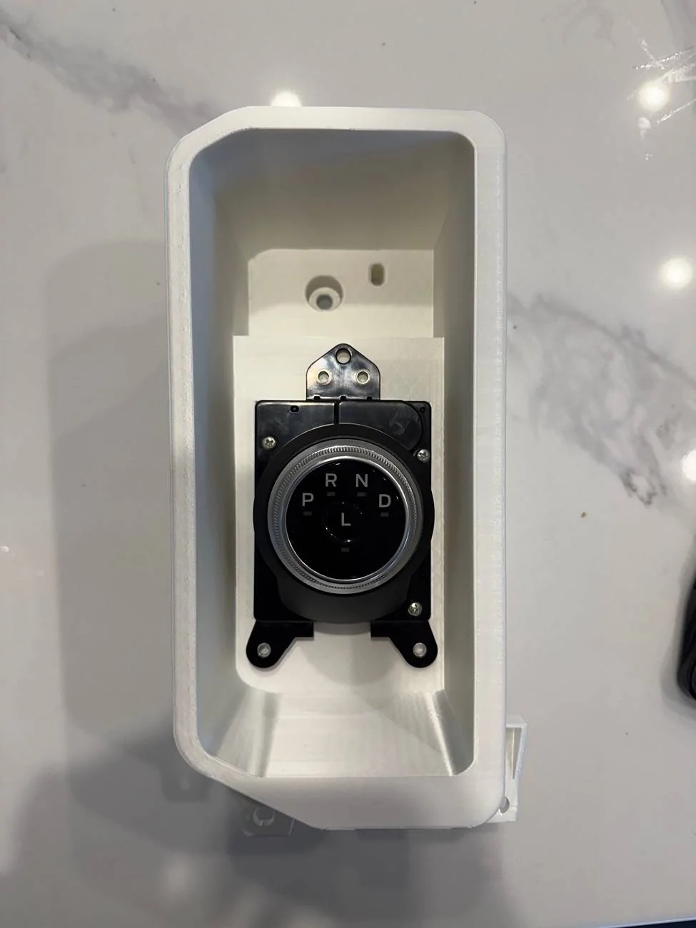

from my understanding the electronics will work as long as it’s 2022 or newer. But as for will it fit to your specific tub and where the harness connector is in relation to the tub, that may change. I don’t know if you have access to a 3D printer or are planning to order an already printed tub, but you may want to check with the instructions on the tub for which one they used. I customized my CAD file for what I wanted and printed it myself (which I’m happy to share.)
In the attached pictures you’ll see the knob I ordered, and how I designed the tub to hold the knob. I then printed a cover which goes over top of the knob. The knob and the cover are friction fit in my design.
it’s worth noting that I went off spec for the 3D print as I have that skill set. But for those who don’t watch this YouTube video

Yeah I saw the video and found the guy on Etsy that sells the tubs. Just wanted to make sure that it will work on the 2025 and bolt up the same as the shifter assembly. Wanted to verify there wasn’t some obscure design change that wouldn’t allow the knob or tub to work on a brand new model truck. Is your truck a newer one?

Mine is a 2023. His is a 2022. As far as I know, there is no physical changes to mounting points on the truck for the tub because that would effect F150 as well as Lightning and it would be a parts disaster.
as for the mounting points on the knobs changing between the model of knob, that I do not know.
