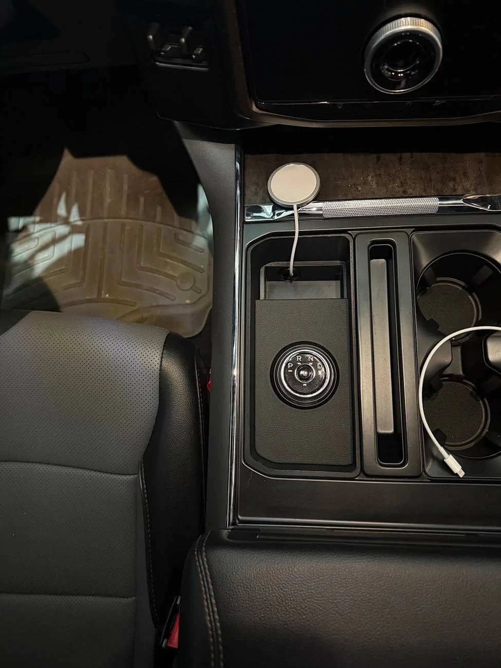

Dropped my truck off at the dealer yesterday and they said the shifter was on back order. How long have people been having to wait for their faulty lightning shifters to be replaced at the dealer?
Considering having it towed back to my house and installing the rotary shifter myself (even though I prefer the feel of the stock shifter).

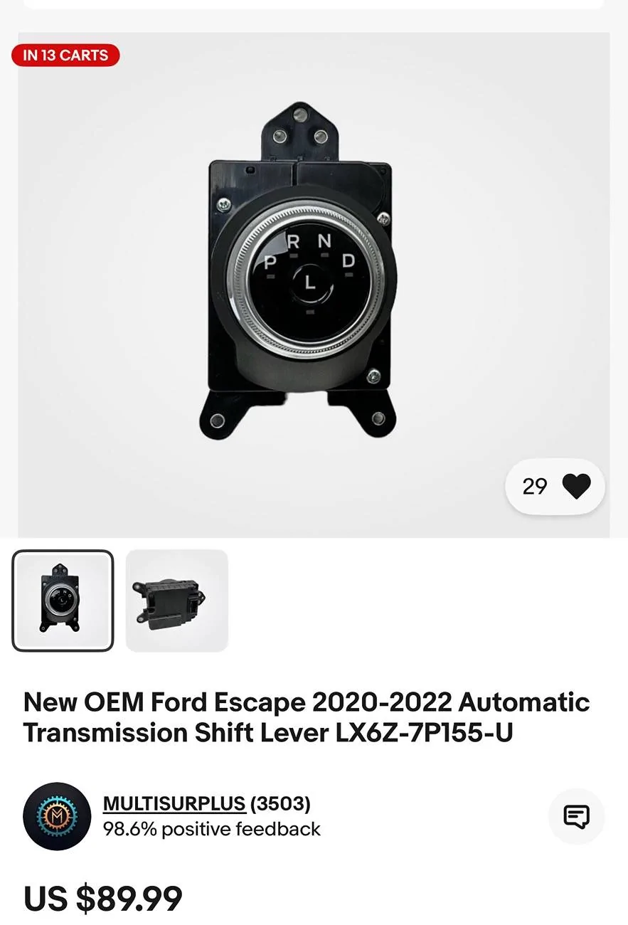

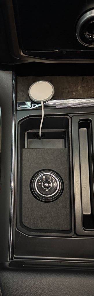

Nice! Which part number did you get for the rotary shifter?
I bought the attached shifter on eBay, there are a lot of options that all use the same wiring harness and that I understand are compatible but I can only confirm personally that this one works. All the logic is located on the shift module itself. E,g. If you open the door with your seatbelt off and shifter in drive, it will go to park just like stock shifter.
as for the plasticy bits, you can order a design off of Pinterest, but since I have a 3D printer and am alright with CAD, I found a template on Thingiverse and then fully rebuilt it myself so that I could make a mini phone compartment and wrap the top of it in leather since I don’t LOVE the look of a 3D printed texture not really matching the stock plastics.
