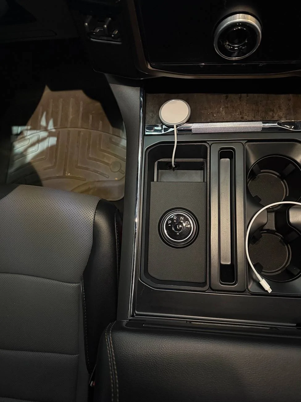

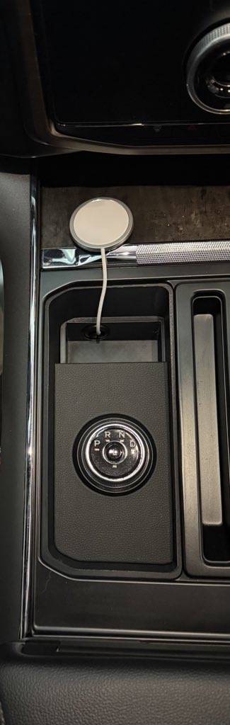

So ANY of the rotary knobs off a Bronco or MachE or Explorer will work?
from my understanding the electronics will work as long as it’s 2022 or newer. But as for will it fit to your specific tub and where the harness connector is in relation to the tub, that may change. I don’t know if you have access to a 3D printer or are planning to order an already printed tub, but you may want to check with the instructions on the tub for which one they used. I customized my CAD file for what I wanted and printed it myself (which I’m happy to share.)
In the attached pictures you’ll see the knob I ordered, and how I designed the tub to hold the knob. I then printed a cover which goes over top of the knob. The knob and the cover are friction fit in my design.
it’s worth noting that I went off spec for the 3D print as I have that skill set. But for those who don’t watch this YouTube video
