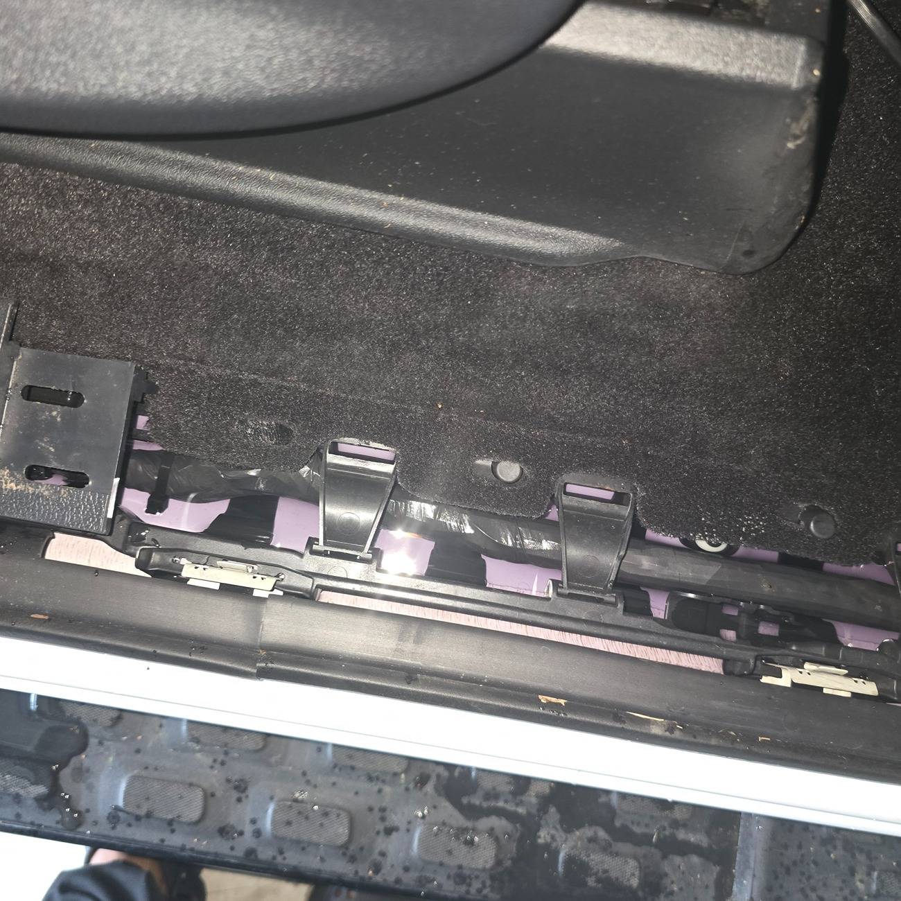

I have my truck in the shop for a similar issue. It’s a little validating that it’s not just me, but thankful it’s not the masses that are dealing with this. My truck is never garaged and made it 30k in one year until the terrible musty smell appeared. I assumed it was a cabin air filter, or a rodent, then maybe the hvac system until finally after chasing my tail I realized the passenger floor under my PRO’s vinyl floor was soaked. The entire truck smells musty and anything that goes in it including your clothes come out with that smell lingering on it. Couldn’t have been worse timing as I have a toddler and a pregnant wife and that truck was the family vehicle we would travel everywhere in. It got so bad my wife would run from me so my smell (the truck’s smell) wouldn’t literally make her sick when I’d get home from work. Haven’t gotten an update about when they expect to make the repair or how. It’s been in the shop for 8 working days.
