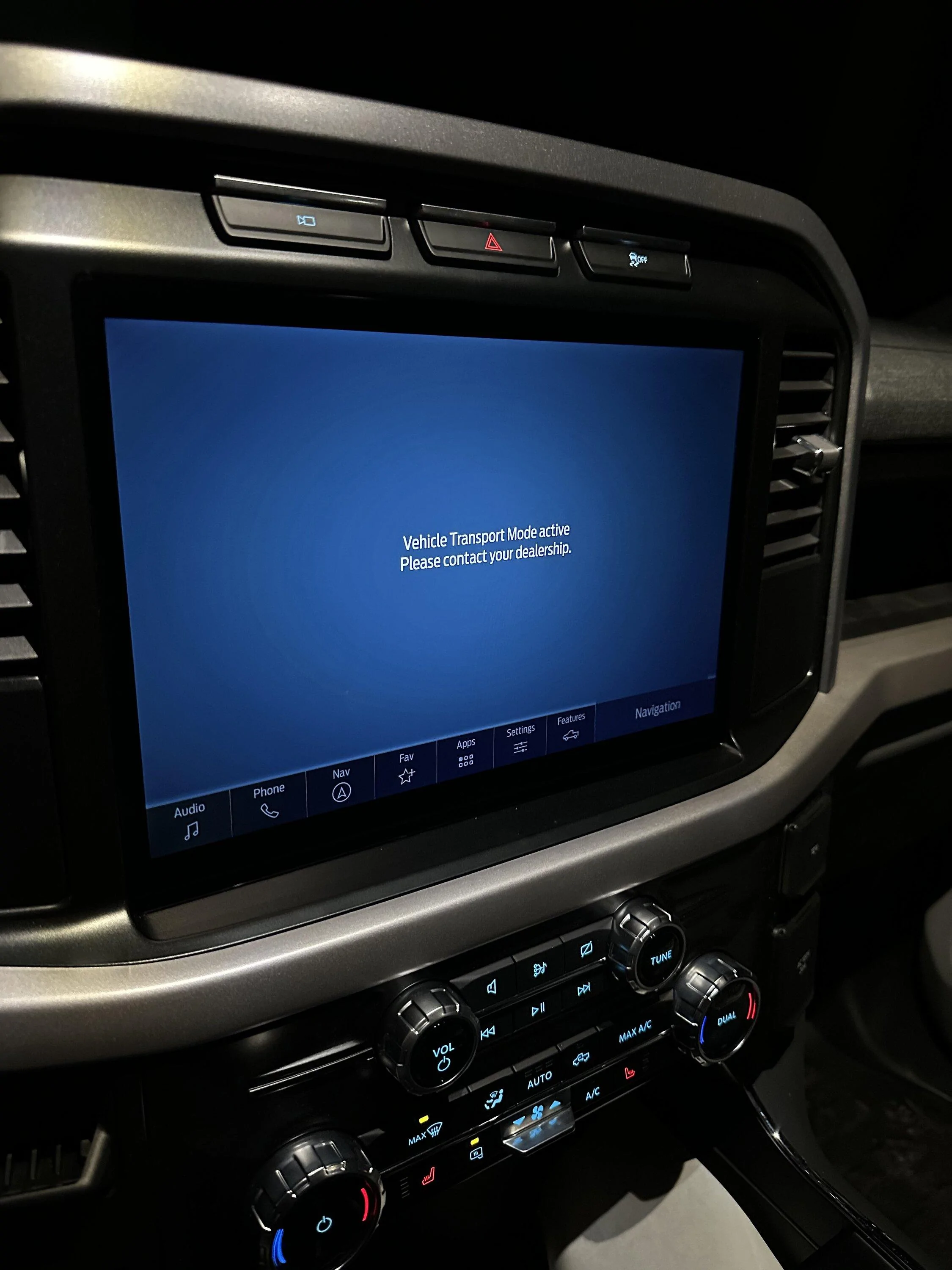

Anyone seen this screen before? Got my new truck dropped off at the house last night and this is the on screen display.
Never saw it on my last one.

The factory puts it in transport mode so the alarms don't constantly go off, and I believe there is a speed limiter too. They definitely need to take care of that.

Got it sorted out this morning. There is a sequence of pedal and button presses to exit this mode that the dealer was able to provide.
