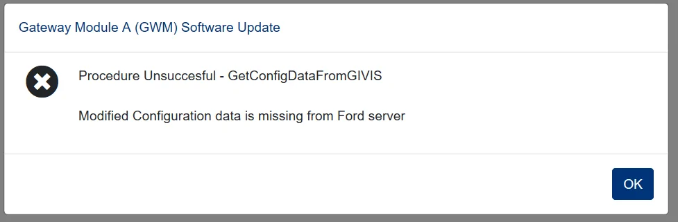

I know Bob_Mac is helping me with this, but I am also getting this error when trying to update the GWM Module A. Just curious if anyone has seen this or knows anything about it.
Ford F-150 Lightning ECU module programming guide using FDRS Screenshot 2022-03-13 120413

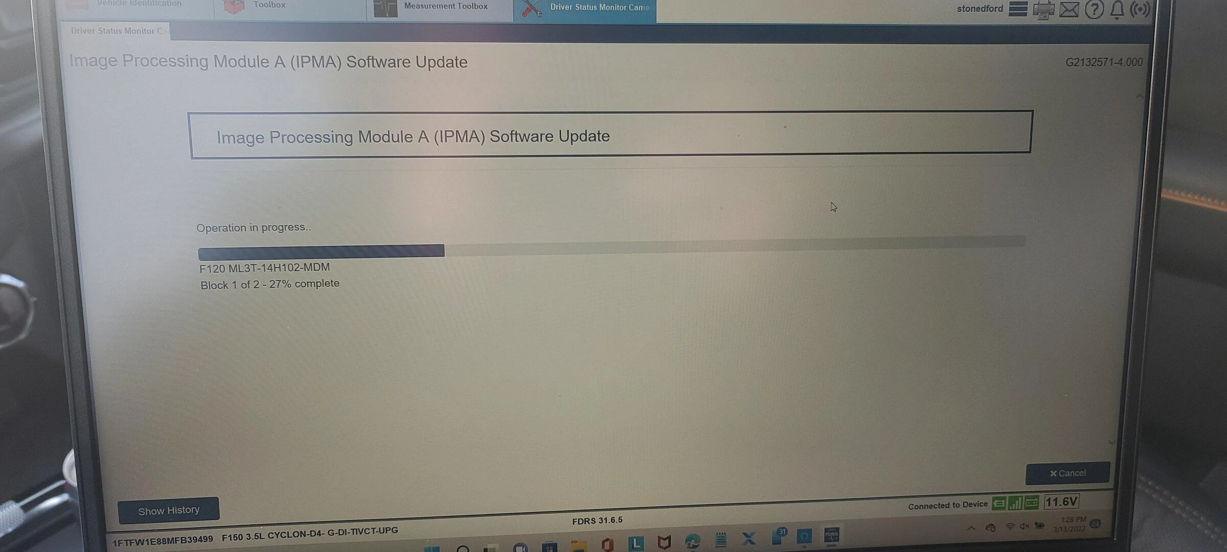

Is cruise control working?
Not sure Ipma is updating now. I did the cmr without an issue. The ccm failed immediately. The pscm updated no issue and now im on impa and its taking forever.
Still trying to think this one through, you did 2 consecutive PMI's on the GWM last night. In the Toolbox what color is the GWM Module?
Pic of your screen? IPMA is a very, very lengthy update.
