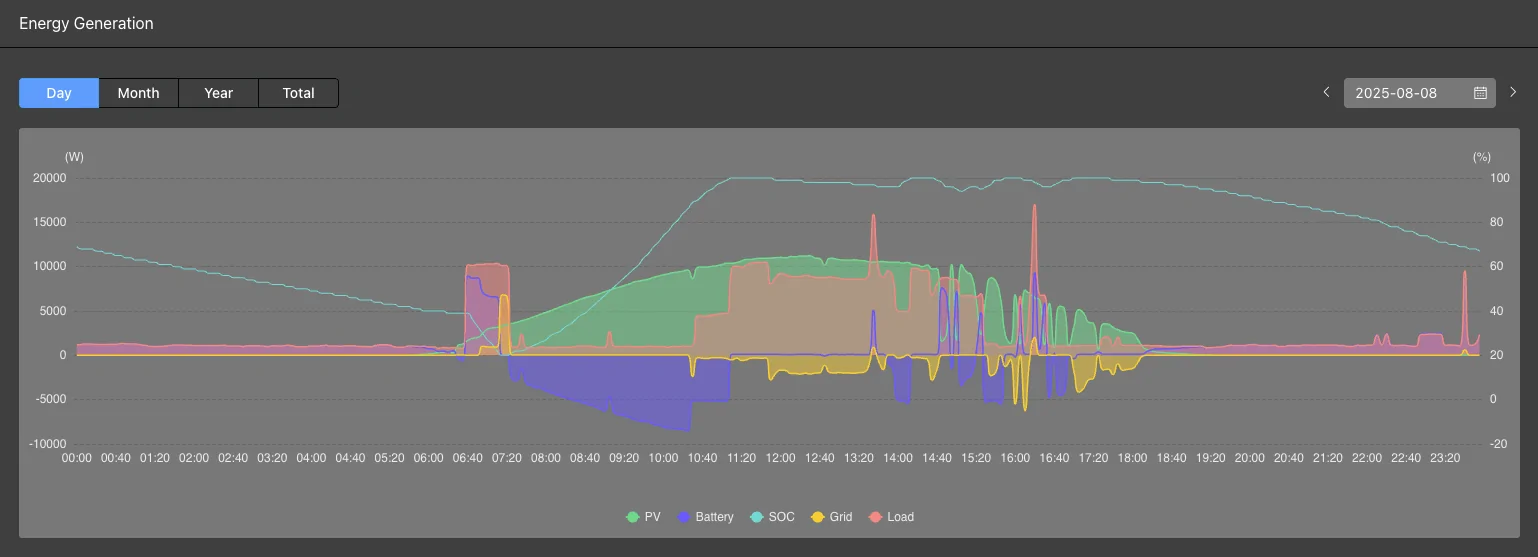

This is a typical day for us: It includes EV charging, whole-home battery charging, clouds, etc.
In the early morning our Mustang was charged. It uses the ChargePoint Home Flex, which doesn’t have the ability to monitor outgoing power, so it just charges when the schedule tells it to. I’m changing that up soon.
At around 10:30, the home battery was still being charged (blue line and blue shaded area), but the solar production (green shaded area) was enough to allow the truck to charge. The truck is programmed not to charge until 10:00. You can see the load (pink shaded area) jump up at 10:30 and again at 11:30 when the battery reached 100%. The grid (yellow) is below 0 (i.e., extra power is still being exported) for most of the day except when we run the stove or water heater, which pull very high power. Our AC runs throughout the day without any issues.

Thanks for the thorough overview... If I may ask what this set up cost you? And what company you used to install?
Thanks!
SpaceEVDriver
Feb 9, 2022
909
1,823
Arizona
Hello,
Thanks!
We used a small, local installer. The cost jumped in the middle of the negotiations because of tariffs. And we have a complicated setup because I have a commercial workshop electrically connected to our residence. I don't think the cost of our system is representative of what typical residential costs are.
That said, the total cost was about $35k with business tax incentives and residential tax incentives.
This is for a 14 kW solar system with 24 kWh of whole-system battery backup, which includes providing 99.99% uptime for my servers.
