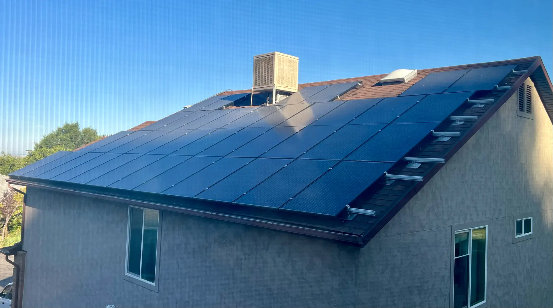

You could do SOLAR to your house and enjoy a Zero $ power bill. This is the last year of the 30% tax credit. I did my house and just had my first bill. $15 for the meter charge and zero power used (Lightning and Tesla charged all month for free). I had $400-$450 power bills.
Agree, we are lucky our daughter installed lots of solar panels a few years ago and just added a battery backup. We live in a large detached garage upstairs apartment using power from her connection. We have a 2024 Lightning Flash and she has a plug in hybrid. I had a Tesla charger installed in the garage and it has been flawless. She is also using a Tesla charger.

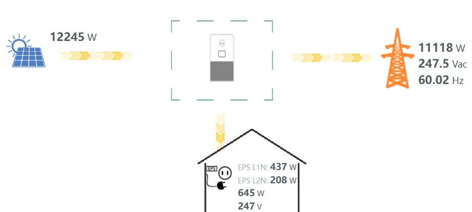

This is a typical day for us: It includes EV charging, whole-home battery charging, clouds, etc.
In the early morning our Mustang was charged. It uses the ChargePoint Home Flex, which doesn’t have the ability to monitor outgoing power, so it just charges when the schedule tells it to. I’m changing that up soon.
At around 10:30, the home battery was still being charged (blue line and blue shaded area), but the solar production (green shaded area) was enough to allow the truck to charge. The truck is programmed not to charge until 10:00. You can see the load (pink shaded area) jump up at 10:30 and again at 11:30 when the battery reached 100%. The grid (yellow) is below 0 (i.e., extra power is still being exported) for most of the day except when we run the stove or water heater, which pull very high power. Our AC runs throughout the day without any issues.

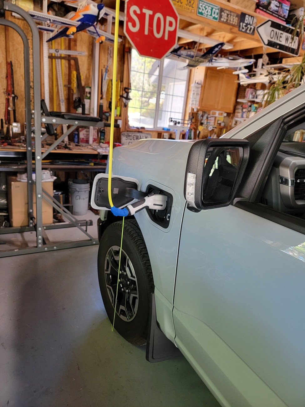

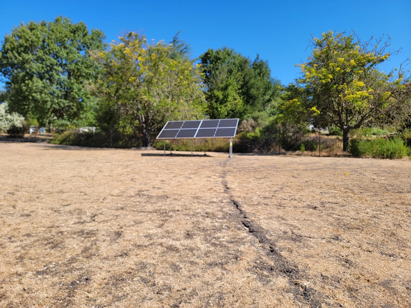

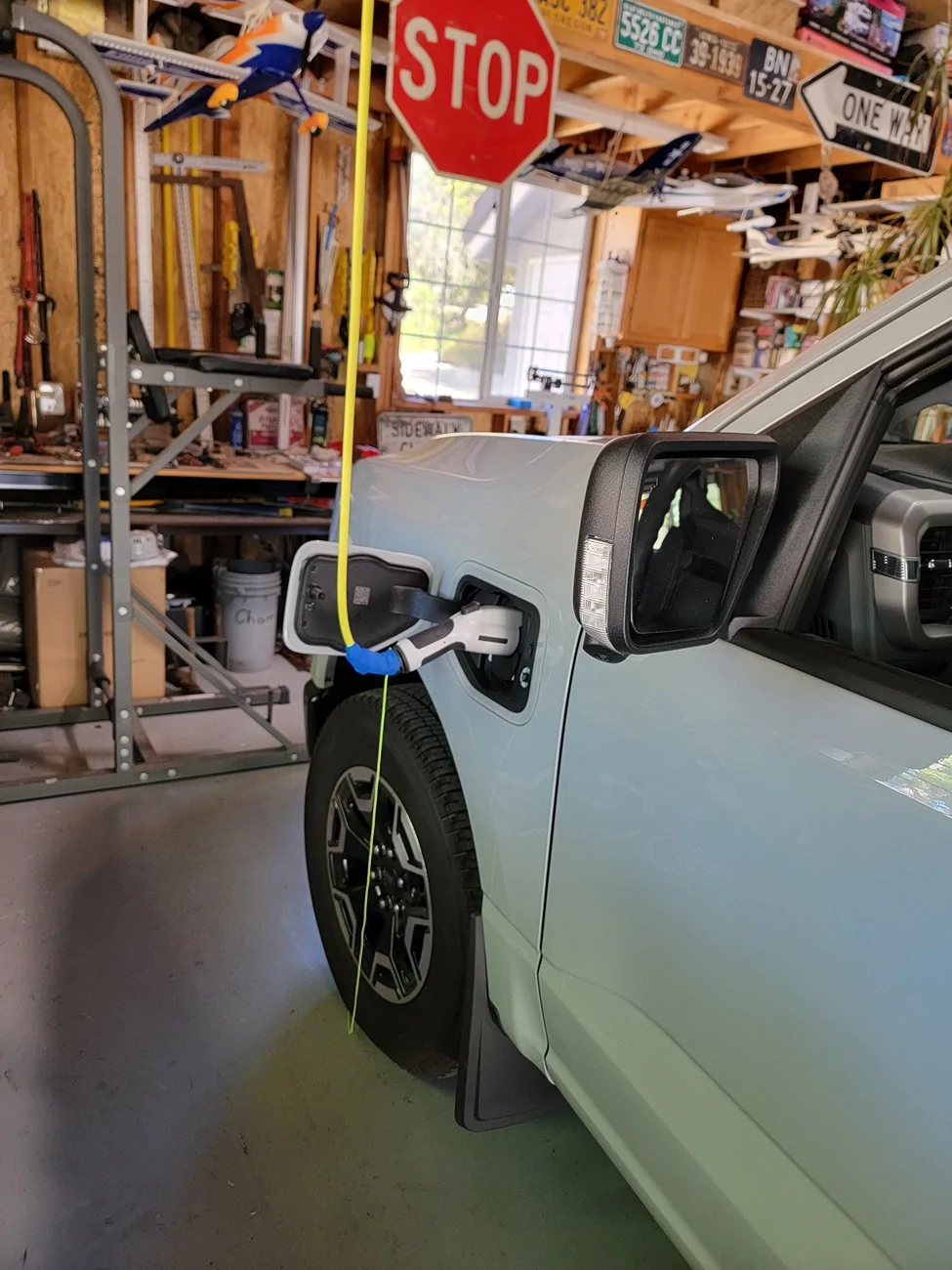

I'm not sure about companies that will do it, but I put in my own, off grid level 1 charging system that works great for my needs. Because I use my truck for "truck" things and not as an everyday driver, it sits in my shop most of the time. Because of that, I elected to buy the Pro model and saved considerably on my truck purchase.....so much so that I figured I could invest in a specific solar charging system just for the truck. Another justification for buying the truck was to be able to power my entire home in case of power outages.
So, having it charged up and available was important. Although I already have grid tied whole house solar for my home needs and can use that for level II charging the truck if needed, I elected to keep my truck system off grid and specific for the truck.
I purchased and installed 4 Jinko 465w panels, installed a ground mount system and coupled that with a portable inverter/solar controller and 5kWh battery system suggested by Will Prose on YouTube (see photos). This whole setup cost me about $4K
This system is working well for me. It charges the truck at about 9 kWh/day....not a lot, but sufficient for my needs. That equates to about 20 mi of range per day. It's pretty much automatic....I just leave the level 1 charger plugged into the truck all the time and when the solar battery is fully recharged in the morning from the solar, the inverter turns on and the level 1 charger starts charging the truck.....fully automatic! Slick!
So, since the truck is usually sitting there fully charged, I can use it to power my house, but also, I have a level II charged plugged into the PPO outlet in the bed and use that to charge my other EVs....including my Tesla! I can do this WHILE the truck is charging from my off grid solar....very cool!
