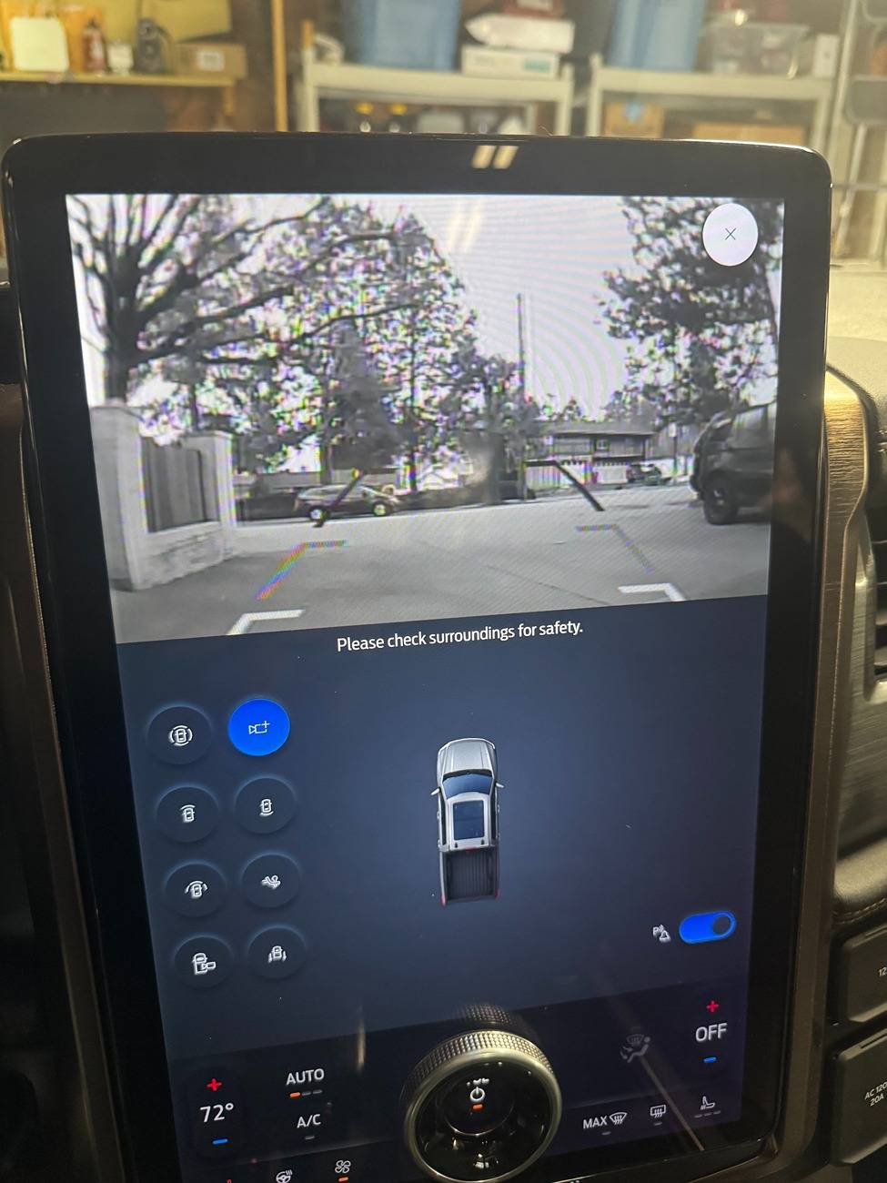

FYI: This is what the end result looks like, testing the new Cam with the harness built per the above thread. Cam just sitting on the back bumper for the test:

I just wanted to say thanks for posting the how to instructions for the wireless auxiliary trailer camera using the integrated truck screen you saved me $1150.00 that's how much Ford wants for that camera wire harness ,not to mention I really didn't want to drill holes in my new camper trailer for the wires . How cool is that wireless transmitter/ receiver from Amazon works great and only $13. But I could have never done it without knowing what and where the four pins I needed out of the 12 that were there , I didn't even know that plug was there so thanks again I now have a perfectly good trailer camera for under 50 bucks thanks to you.
