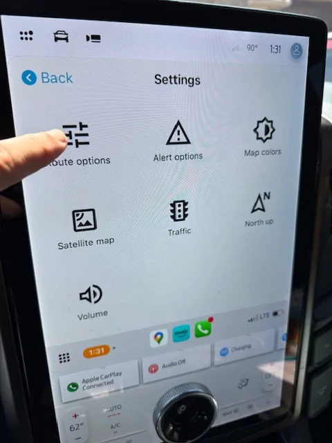

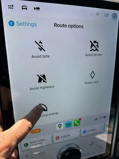

I think I have figured out how to "jump start" or fix this issue.
I am not sure how, but one of my 2 iphones suddenly started working, so I knew it wasn't a truck issue holding me back.
I connected to carplay with the other phone and began to try and figure it out.
While in google maps on the screen, I changed one of the settings (completely un-related to anything having to do with this feature), but it seemed to trigger something in the code, and now the dash display is working every time. In my case I went into settings (cog wheel) -> route options -> (toggle) saving energy.
For reference both phones have the latest iOS and Google map versions. Both phones now work on the dash display even in wireless CarPlay mode.

That does make sense, because when it wasn't working for me, on the iPhone I would no longer see "my vehicle" selected as an EV, whereas before I did. So by selecting Saving Energy, you're toggling the EV feature(s). Perhaps.
