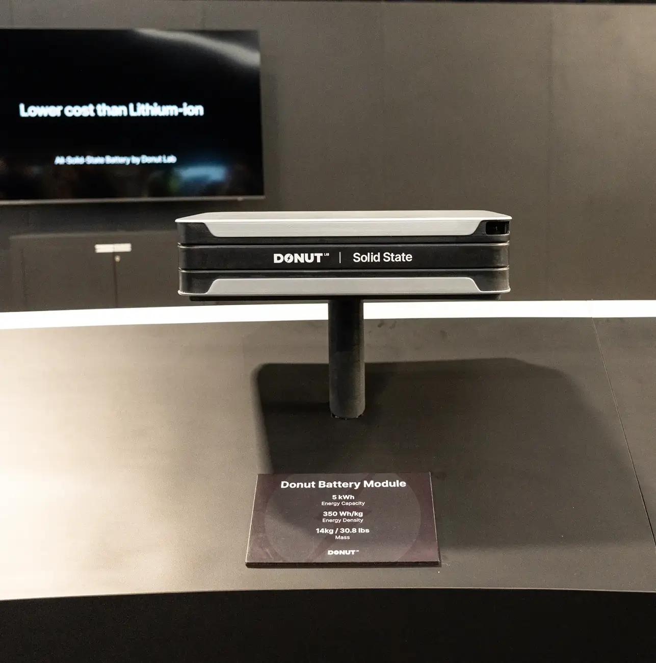

For reference.. this is the module that 60 of those pouch cells picture would need to fit in, claiming 5kWh capacity.
If you are going to make outrageously extraordinary claims, then you need to, at very least, show your math. What figure are you using for volumetric energy density and what dimensions are you using for the pack. Without your showing the math, It is impossible to discern WTF you re trying to say here.

Obviously if we're talking about the number of cells necessary we're talking about capacity and size. Simple explanation -- I left out the h. It was a typo. :)
As usual here, the math doesn't math.
Show the fricking math. Show their claim for volumetric energy density and show that the pack is too small. (Do you think that the pack is the size of its representation oon your computer screen?? It's not. )
If only you treated your boy Marky Marko with the same standards..
4.17v, that pouch cell they showed had a capacity of 26Ah.
57 of those things are _NOT_ fitting in that module.
They are neither claiming nor demonstrating 4.17 volts as a nominal voltage. Read the report. Find the right figure.
You are clueless or lying re the size of the module; you are clueless or lying re the volumetric energy density. Show the math or I can only conclude that you a belligerent prick because it is fun for you. It's not fun for me. It's the sort of cyberbullying that erodes the utility of the internet and of this forum.

Given that it does not appear that Shmoe is willing to do even the simplest math, here is a project for anyone who actually cares, and is not here just to be a prick.
Let's round the likely volumetric energy density to 1000 Wh/L. (research that -- you will find it typical for SS.)
Without needing any sort of calculator, anyone who can read this is also probably able to see that a 5000Wh battery would have to be 5 liters (in other words 5000 cc.)
Let's say that the pack is about the size of piece of paper (8 1/2 x 11 in the US) in plan view, and a little over 3 inches thick: say roughly 22 cm x 28 cm x 8.5 cm. That's 5236 cc. You can do that by hand on a napkin in 30 seconds, and even faster if you use a calculator. That appears very clearly in the ball park for the 5kWh pack mockup that Donut showed at CES.
If I were going to guess at the actual pack size shown, I would have said that is is a little larger than a sheet of paper in plan. But who cares? it is obviously in the ball park There is nothing remotely extraordinary or revolutionary or wild about 1000 Wh/L. It is as exciting as oatmeal.
What next ? "Good God man! "Batteries cannot be black! They should be yellow, like a Winston. Or blue. But not black!!! What a string of endless bullshit.
