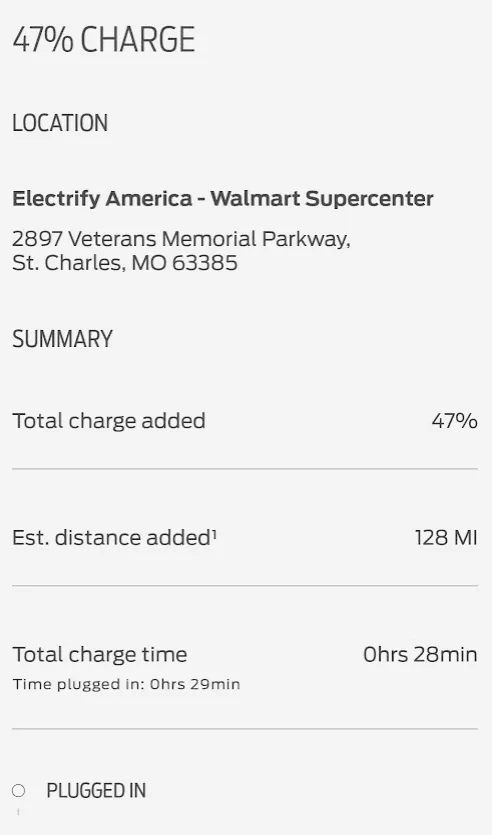

Just for reference I did 47% charge from 24% to 71% for 62 kwh in 28 minutes recent road trip. Which is very close to 130 kwh average. So Kyle's number is not an aberration. I think the sweet spot is closer to 20 minutes charging rather than a longer 28 minute one I did. Get a 30% charge in the 10% to 80% band and you hit the charging sweet spot. The Lightning hovered from 115 to 122 kw in the last 10% or so of my charge so if I that stopped a bit earlier 135 kwh average is very reasonable.

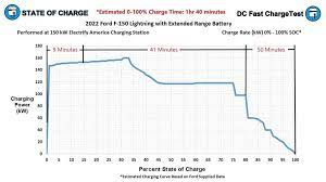

I am sure a comprehensive charge test is coming ..but here is the hypothetical charge curve based on data given to Tom Moloughney from Ford
0-15% in 9min(est)
15-80% in 41min
0-80% in 50min

I sent Tom an e-mail about that plot. It doesn't make sense compared to real world charging performance. He shows rate dropping at 35% SOC whereas many people have experienced the rate being steady until 50% SOC and then tapering steadily over the course of 50% to 80%, whereas he shows the taper happening from 35% to 45% then flat from 45-75%. I think there's something off with the plot. Maybe Ford gave him outdated data?

Has this charger location consistently charged at this rate for you in the Lightning?
We have not been able to any DC Fast charger to stay above 120kW for more than a few minutes. Our charging was primarily at Boonville, MO EA 350kW charger in the middle of a trip on I-70. I am wondering if it is because the truck is too hot. Some are towing trips, some are not.
Was the charging session above after little driving or 70MPH for hours?
Do you have the max towing package?

SR or ER?
Mine is ER platinum so has all the options.
TBH your situation sounds like normal behavior. After the initial burst anything from 80-130kw is normal depending on weather, charge state, cell voltages, etc. Mine tends towards 128-132 so far but this is summer. Will change in winter, your may think different.
It depends on the station. At the St Charles location station #2 has got me to 166-172 kw for the first 10-15 minutes. usually get about 80-100 miles or 30%-40% charge. Have charged here 4 times this past 2 months. Station #3 once gave me just 34kw so I moved.
I used Booneville probably 10+ times past 2 months with. Usually Station #3 & #4 do well. Station #2 is unpredictable.
As long as you are driving above 40 mph the truck battery will never get above 30c. The cooler is powerful enough to to get the battery from 45c to 30c in 2 minutes under DC fc charging at 60 kw, check out some of the charge curve videos. Even towing you won't exceed that for more than a few seconds.
The logic the truck uses to set the charge speed is a mystery to us all. We make some educated guesses but only the truck logic knows what it is doing. You might have to experiment with chargers and SoC you arrive at to see what your truck says.
