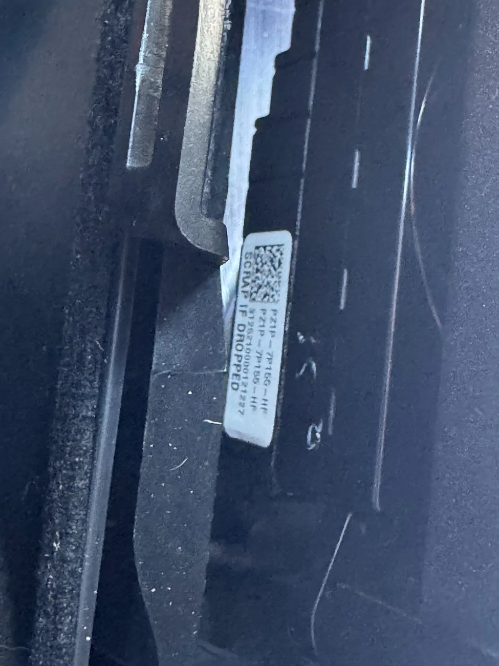

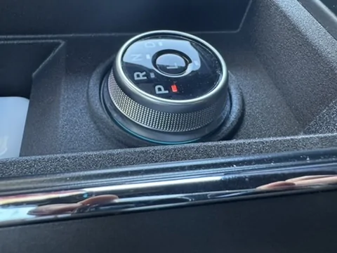

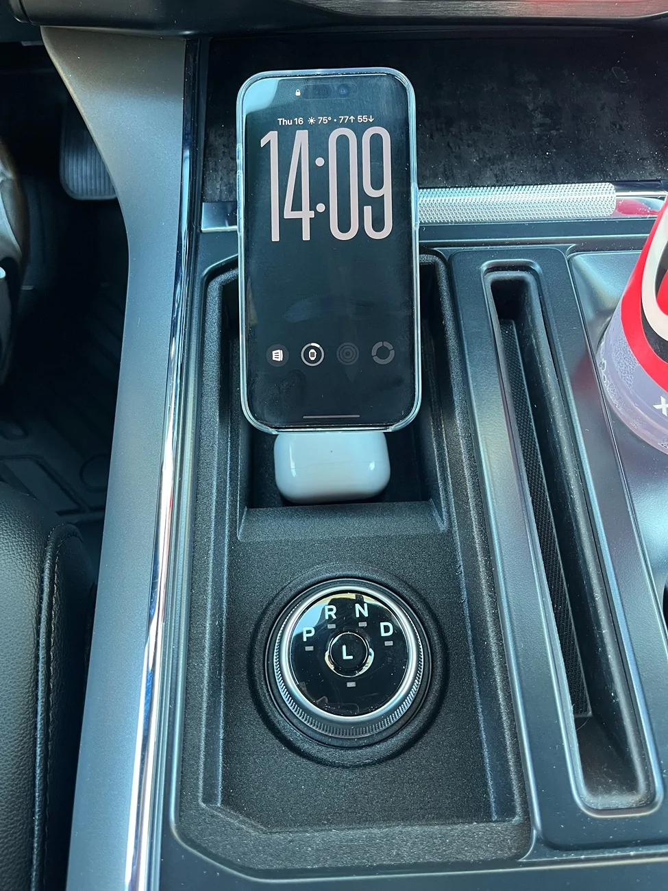

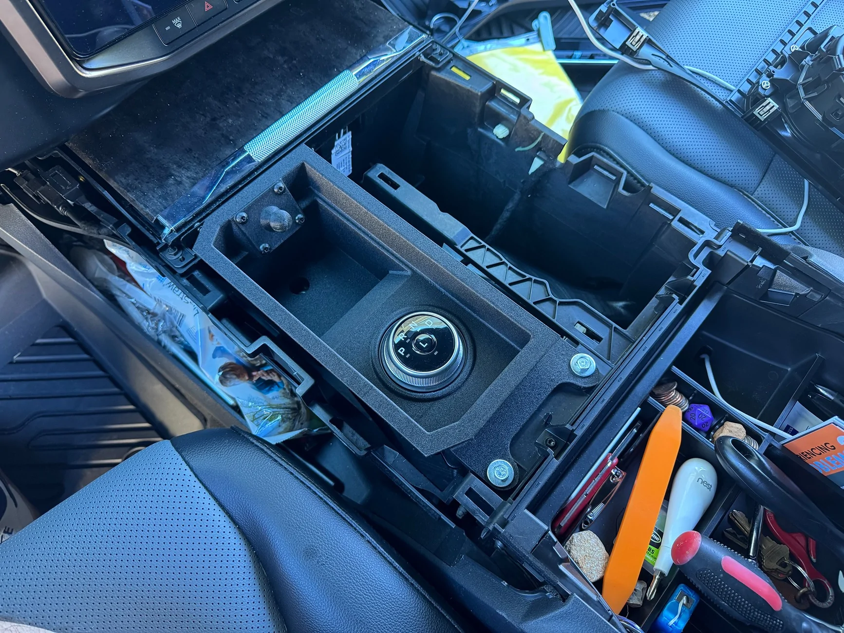

Another vote for @PolymerBuilt's cubby! Ordered a PZ1Z-7P155-AM from here and was sent a PZ1Z-7P155-HF which worked perfectly. This is the non-motorized, blue ambient light and "L" button variant from an Escape. Test fit with this 17mm mount while a couple other pieces are in the mail.
Took about 20 minutes going slowly and following @branden YouTube tutorial exactly.
Such a nice improvement over the stock shifter.

You can just barely see the base lighting in daylight.
