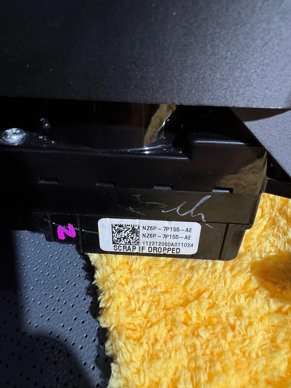

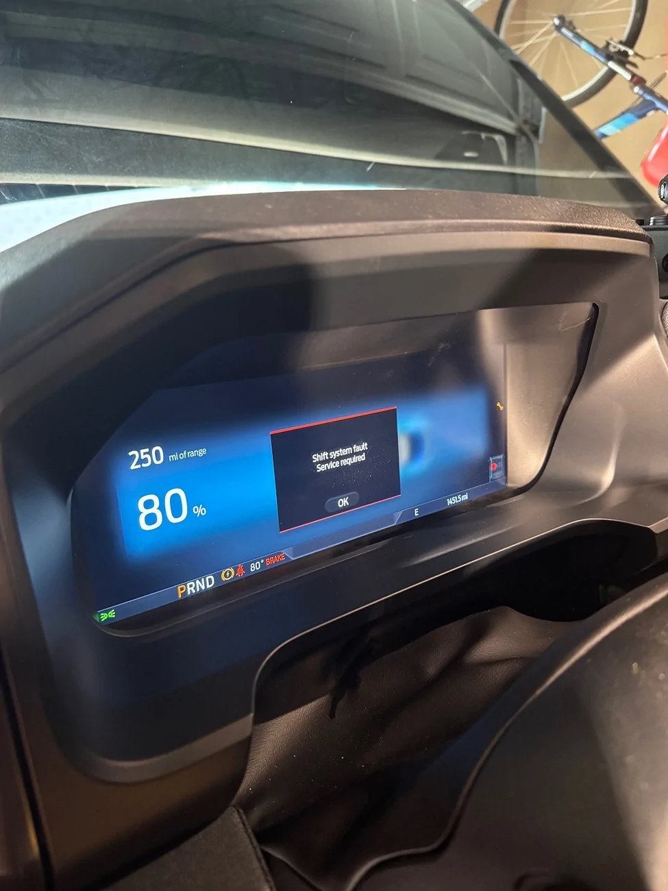

2025 Lariat here. Second time I have tried to install the rotary shifter without success. This time i disconnected the 12v battery until the install was complete. OEM shifter works fine when re-installed.
Codes (see pictures attached):
"Shift system fault service required"
"Park brake limited function service required"
The shifter is from a Maverick
(NZ6P-7P155-AE) and I am showing this as compatible per first 8 digits:

One suggestion is to post a pic of your OEM shifter part sticker and let other owners compare with theirs. If you have the same OEM part as other successful mods then you can rule out TRON. Thus likely a bad rotary shifter. Was it used from a salvaged truck?

By any chance did you forget to plug back in the wires for the dead battery for thekeyless start system?
