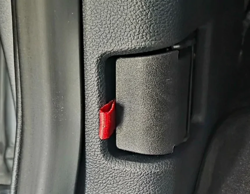

Just be sure you have a key handy to get into the truck when the 12v battery goes dead...otherwise you'd have to find a way to jump/charge the battery externally.
Of course if you added a battery maintainer wire (like I did) and used a maintainer daily, no problemo.
Ford F-150 Lightning Strange, frunk opened, truck unlocked?? IMG_6004
