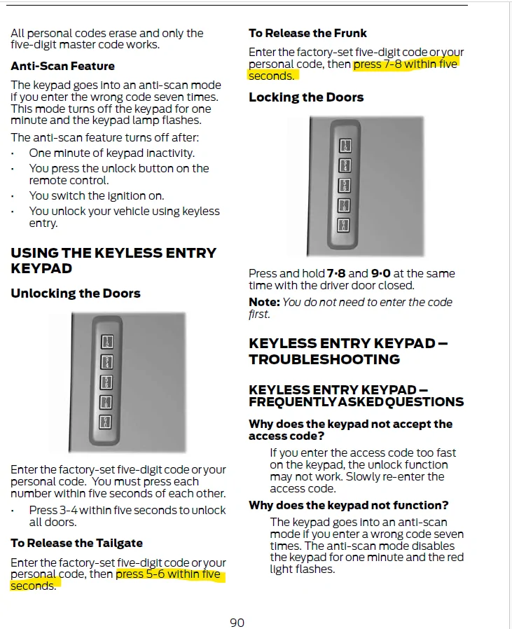

so then I went up to the key pad and unlocked it that way. Right after the truck unlocked, my trunk opened normally with no error message.
After entering your door code, there is an option to follow-up w/i 5 seconds with a:
  • 7/8 to OPEN Frunk, or a
  • 5/6 to open the tailgate.
Ford F-150 Lightning Frunk Randomly Opened When Truck Was Unlocked 1759592339503-sk
Yep, they bumped that other button and popped the frunk.

That has to be it, my code overlaps and I usually just keep mashing it in til my truck unlocks. Such a simple answer, I love it. I was considerably befuddled when I looked up and saw the frunk open lol
