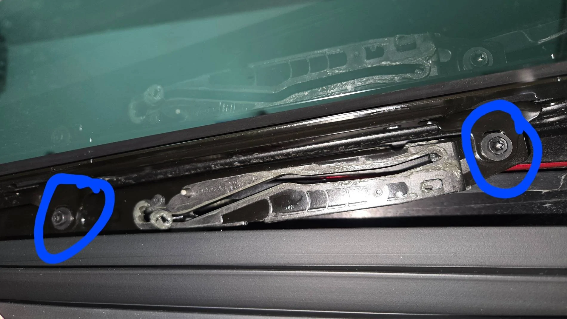

I'm pretty sure the headliner will have to come out for the replacement, so not just a 1 hour repair.
That's what I thought too but after checking I now think it's a really simple job. There are three torx screws on either side of the panel and it comes out the top. In the photo below, I've circled two of the three screws on one side.
I though it had been determined that the sunroof is only serviced as a complete assembly? If you can get just the glass, then you may be correct.
Maybe. On an older truck I was able to replace the rail system only. If the part number is for the entire assembly it would be ridiculous to spend a day of labor replacing parts that don't need to be replaced. Install the glass and put the rails in storage until they break in 10 years.
