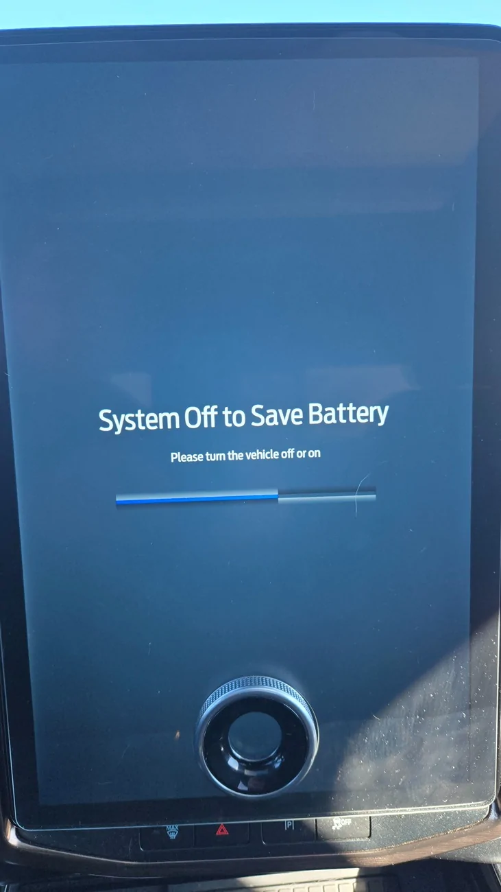

The OP was in March of this year and despite 15 responses, I don't see any real explanation of what is happening and why. My post was over a month ago and it's happened twice since then including today. Truck was parked at home and had plugged in for two days. I "start" the truck and up pops up this message:
Ford F-150 Lightning System Off to Save Battery message 20251126_130509
now, it's still on the screen as I'm backing out the carport. it goes away after 10 seconds or so. My My Lariat is a 23 with 20k miles. videos on line indicate this is a problem with other Ford ICE vehicles as well. I'm pretty sure my BMS was updated sometime last year. So is this just a bug that goes away or do I need to take my truck in for service?

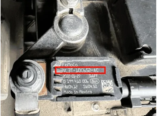

Here is the main thread. The 4th attachment there tells you what to look for. Bad part numbers end with AC or AD. The CSP ended this past January.
Example bad one:
Ford F-150 Lightning System Off to Save Battery message 1764203659016-b5
