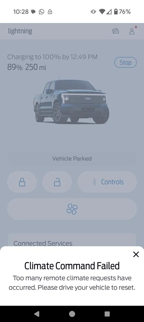

Jumping in on this thread. Today, its 8 degrees in the balmy northeast, a perfect day to pre heat up the lightning so I can excavate it from the snowfall, then drive it all warmed up.
While I appreciate that Ford has given us on-demand remote heat control, instead of the abysmal scheduling function they gave us originally, its only interesting if it actually works.
Here's what I got this morning when I tried..... Tried about 10 times. So basically useless.
Doesn't do this with the Mach E though
Ford F-150 Lightning Temperature 5F, 3 horn sounds, no remote start climate command failed
Yup, you only get 2 remote requests per Key On / Run cycle.
Note the issues I posted above can impact this to ONE shot.
Thanks Tman!
I my case this frigid morning, I had only heated for 1 cycle. When I went to push the extend button, I got the failure message. And it then failed every other time I tried to run another cycle.
I just never understand why they put these goofy artificial limits in the software. Who cares if I want to heat up the car 30 times? its my car...
This is especially true if is plugged in.
