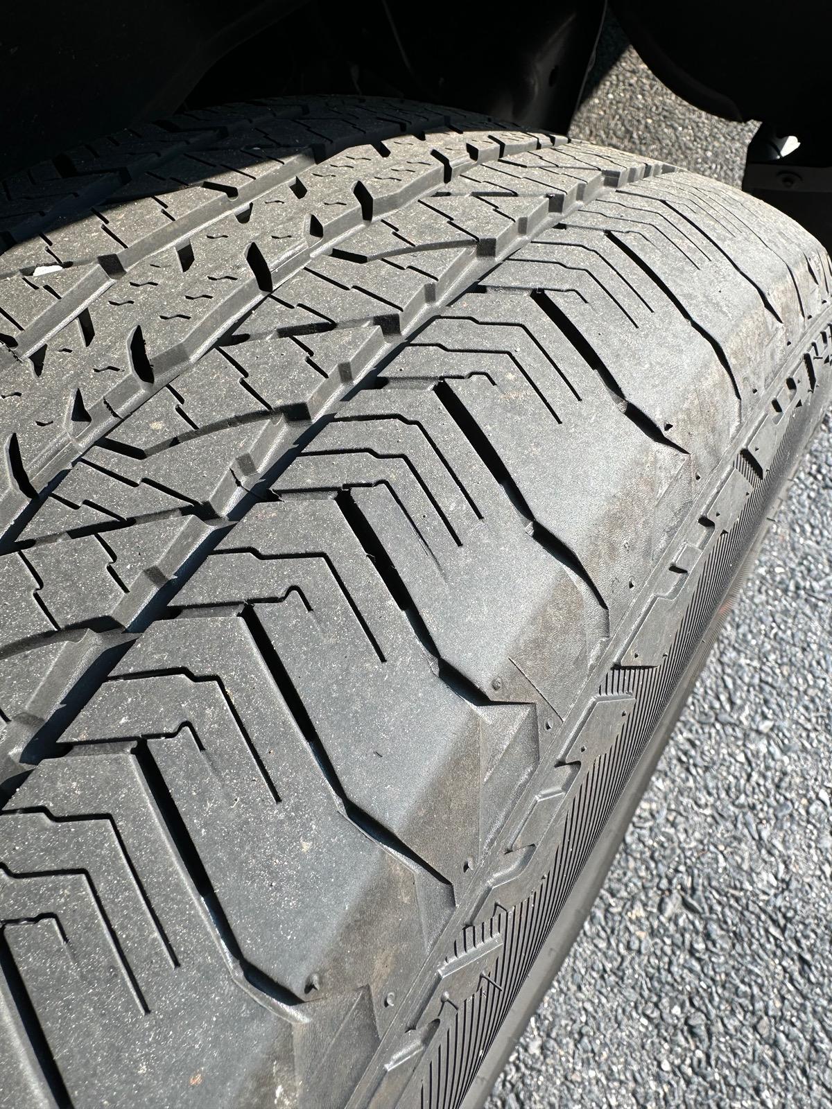

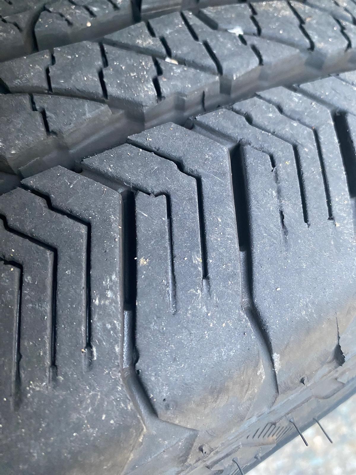

I looked at mine today. 4300 miles / 6 months and there is definitely abnormal wear on front inside tires. I’ll see if dealer will align it under warranty.

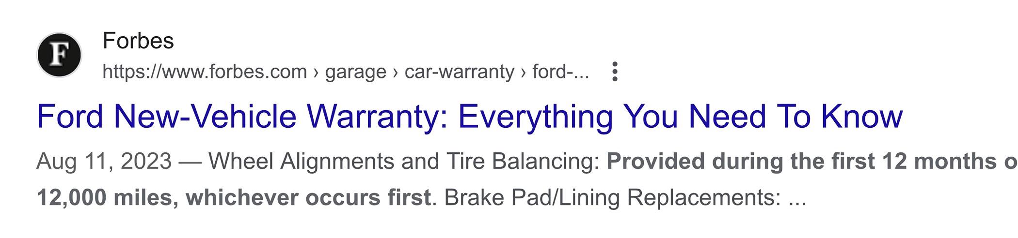

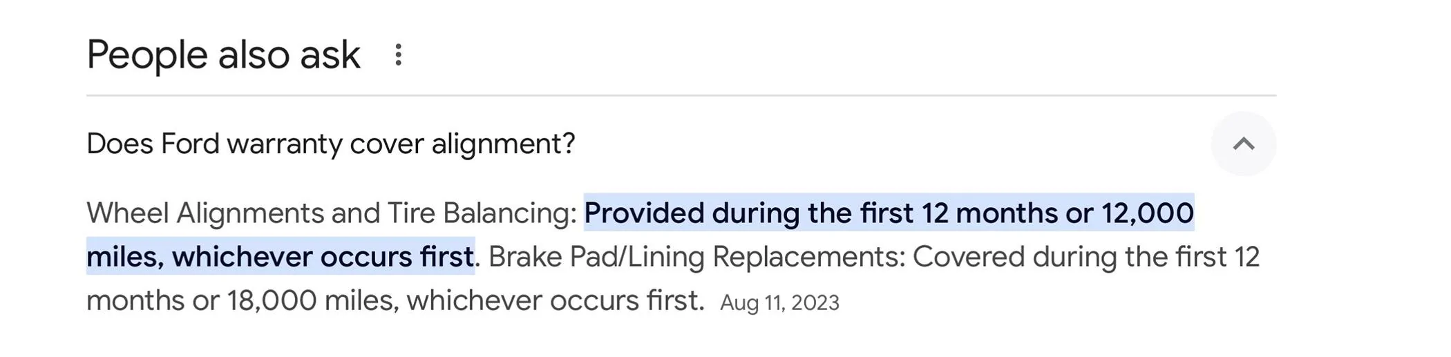

A quick search came up with this: We will see how it goes. I will be going in for the Low voltage battery bms thingy shortly. I’ll. Bring the tire wear up at that visit.

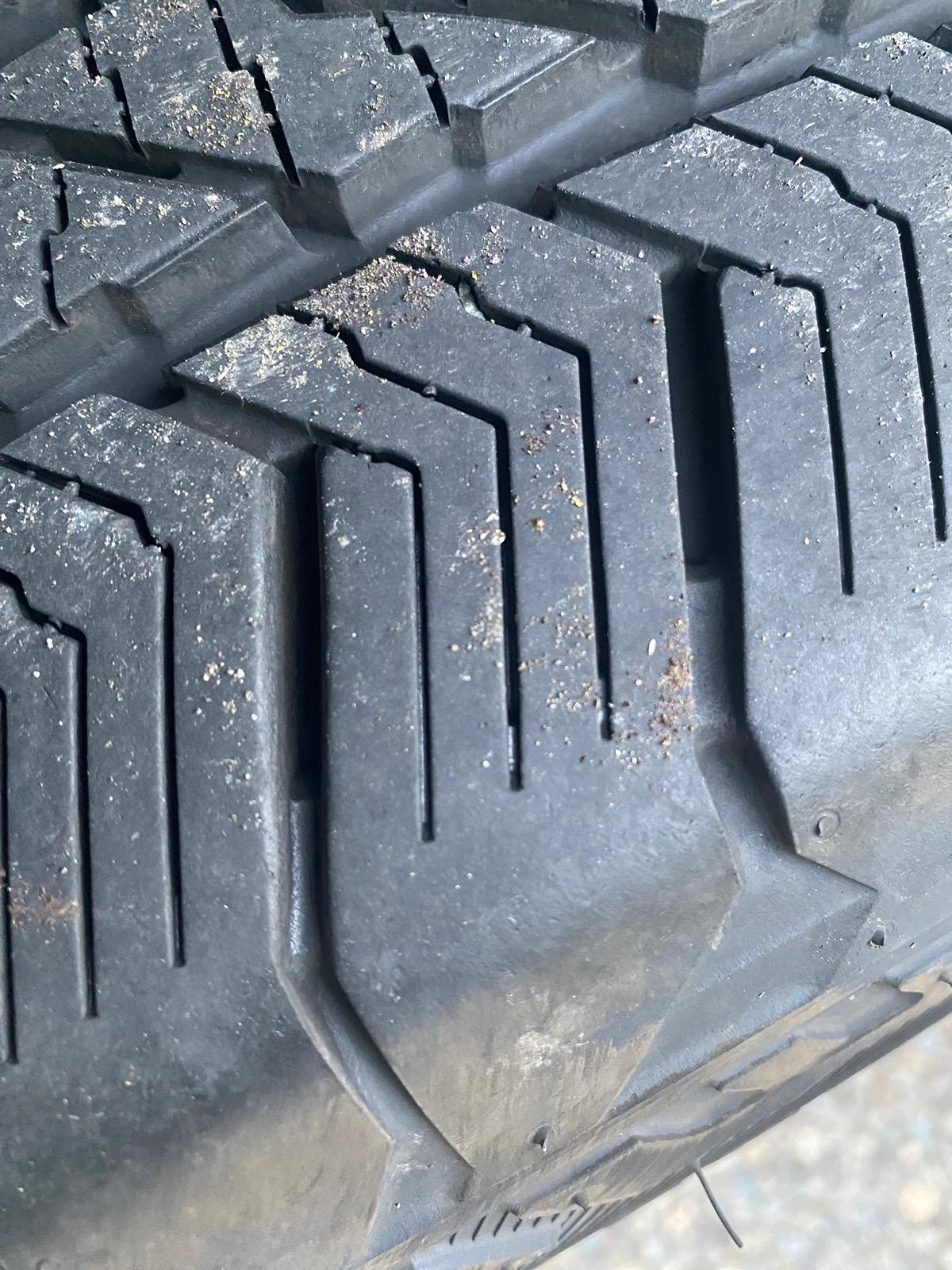

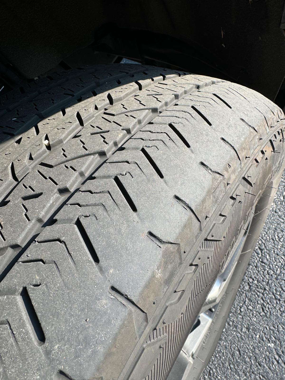

Well well well... super interesting post. I noticed this yesterday and was going to post, and found your thread. I have the IDENTICAL problem. With so many people having this outside-edge tire wear BECAUSE of a poor alignment, it seems to be a FACTORY issue. @Ford Motor Company what do yo say about that? Am I going to be out several hundred bucks for new tires because of poor assembly/alignment? Ford this sounds like a recall service to me... (fingers crossed that my tire warranty add-on covers this)
20k miles, wheels have always been inflated to proper amounts (35-ish psi)
Here is my front tire wear, same on both tires. I also have some wear on the rear tires, but it's not as bad...

35 PSI sounds low. Mine calls for 41.
Have you rotated the tires?

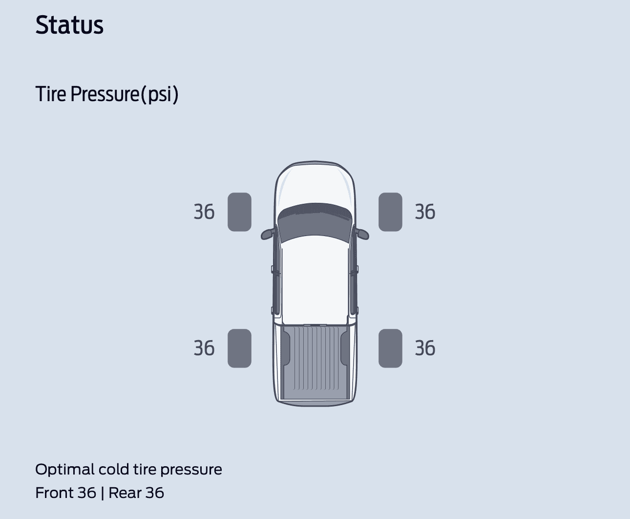

I’d have to check if they rotated the tires at 10k, I don’t remember. And the Ford app says 36 psi is ideal cold psi, and that’s where I’m at. ??

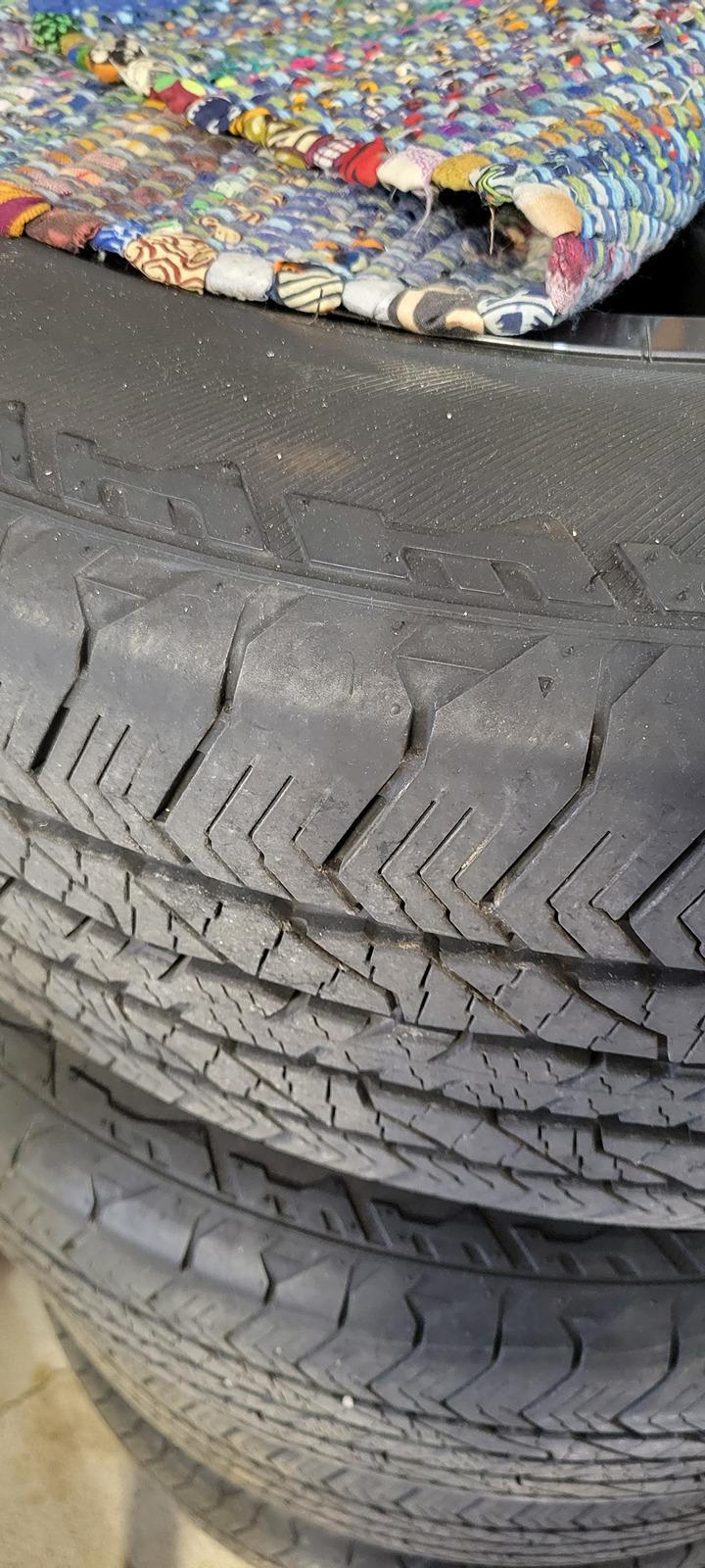

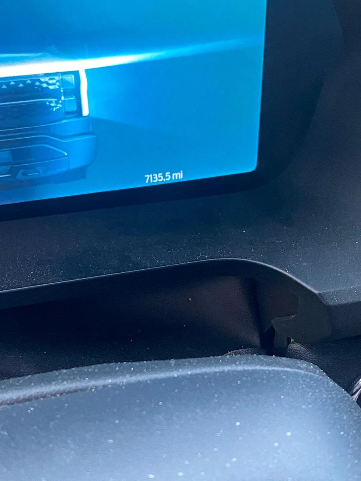

7k miles looks like my fronts are wearing like y’all’s

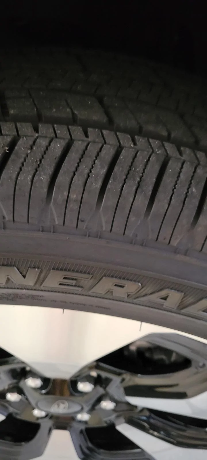

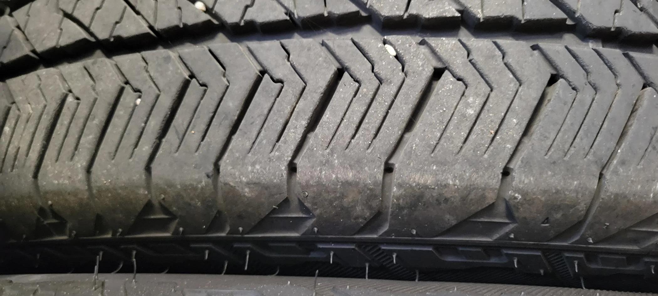

I have a 2022 Platinum with which I run stock wheels and tires (General Grabber All-Season) in the summer and 20" Lariat take-offs (Hankook All-Terrain) in the winter. I run both at 42 psi cold. Both sets of tires have about 10,000 miles. The result is a natural experiment. See photos below.
In my opinion, the Hankooks wear unevenly. My experiment certainly didn't eliminate all variables though so who knows.
This is the outside of a 22" General Grabber All-Season. It's representative of all tires. Consistent wear across the tread.
Ford F-150 Lightning Tire issue or alignment -- Anyone else seeing this kind of wear? 1000004499
This is the outside of a Hankook All-Terrain. It's representative of all tires, more wear on the edges of the tires, especially the outside edge.
Ford F-150 Lightning Tire issue or alignment -- Anyone else seeing this kind of wear? 1000004498
The inside edge of a Hankook All-Terrain. Some uneven wear but not as bad as the outside.
Ford F-150 Lightning Tire issue or alignment -- Anyone else seeing this kind of wear? 1000004500

Must be a lower recommendation due to the less weight of the SR and/or type of tire. I’d still check the sticker in the door jamb to verify, though.
Since the front & rears have about the same miles at each end, it’s possible that something‘s gotten out of alignment on the front since the last rotation. Otherwise, the wear should be about the same.
Door jam sticker also shows 36 psi. So I'm dialed in on that.
"possible something has gotten out of alignment" --> yes for sure something is messed up. And if it's happening to a bunch of owners, then something must be WRONG to have such a common issue? I have never had any thing like this on any car or truck I have owned. Certainly the extra weight is causing an issue, but why are so many people experiencing this problem?
Likely the issue existed when the truck shipped from the factory as the rears are also showing similar wear (although not as much). And I can't verify with 100% certainty that I rotated the tires at 10k miles or not. Still looking for my service receipt on that. I had a bunch of other problems that were fixed by one dealer, only to have that dealer mess a bunch of other things up and had to go to another dealer to correct them... so tire rotation was the least of my worries at the time, especially as I never expected to have such a problem.
