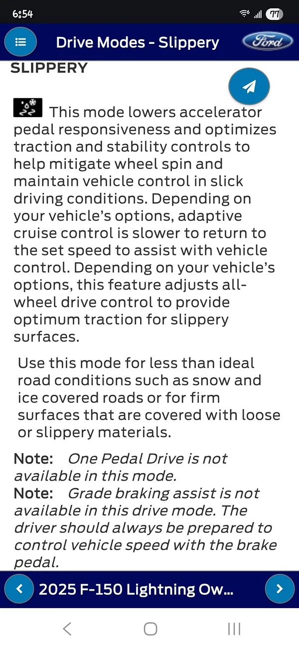

5th drive mode called Slippery.
I assume this is only for use off-road/soft dirt? I would love it for some u-turns I need to make in my neighborhood.
According to the owners manual.
Ford F-150 Lightning Trail Turn Assist? 2025 Slippery mod
[INFO on SLIPPERY MODE]
