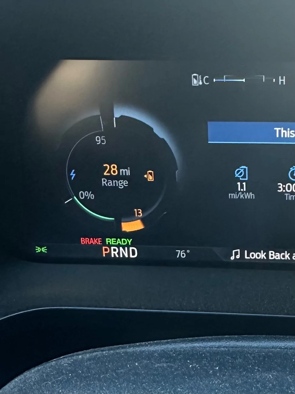

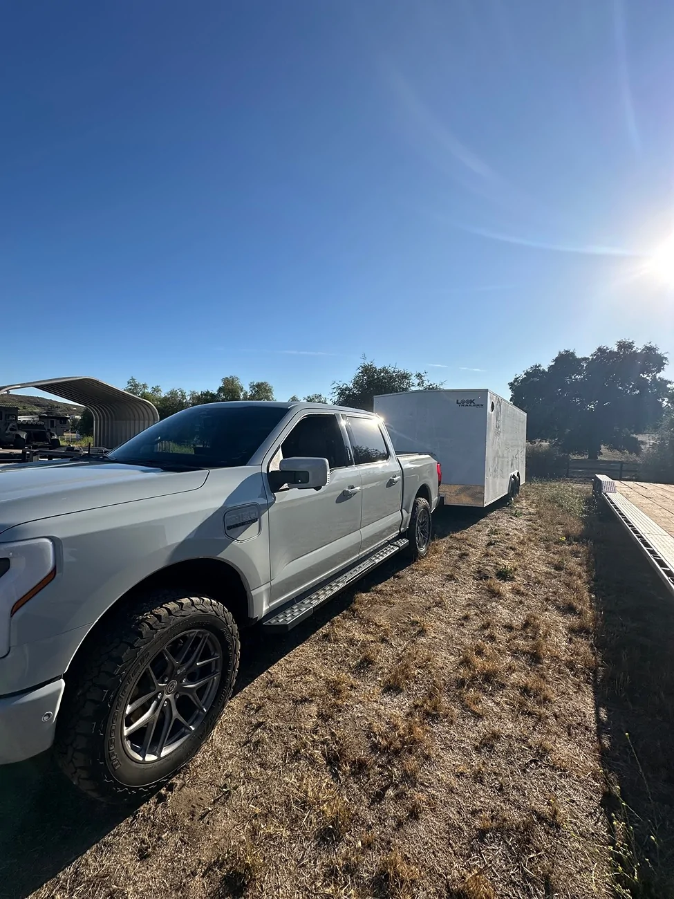

I averaged 1.1 mi/ kwh pulling 8.5x20 trailer 130 miles. Started with 100% charge and ended with 13%. Probably could have done better if I stayed below 70 mph. Truck has ER battery.
For sure You would have done better. Physics is physics and wind resistance i.e. drag is drag. Pretty much no matter what the fuel is, including hydrazine... the different fuels' energy simply adjusts the ratio of range loss.
I find that when towing with my ER Lightning, about 60 - 63 MPH is an optimal speed and anything above 68 MPH just burns electrons without a corresponding gain.
