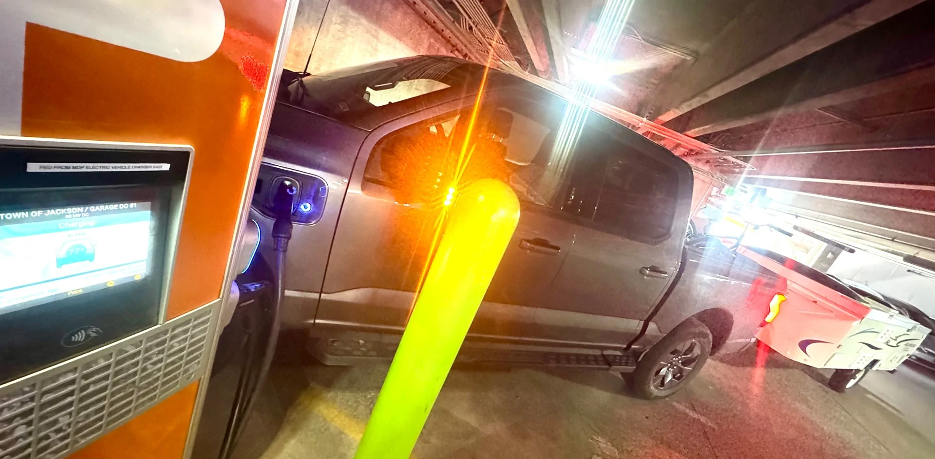

We pulled our ALiner trailer from CO to Tetons, Glacier & Yellowstone and our average range was reduced by 30%. The range estimator (aka Guess O Meter) worked great and I was able to plan legs and charging without a lot of problems using the PlugShare app (a must for remote areas!). NOW, that we have returned home and unplugged the trailer and reset the mileage reader in the software, the GOM is still giving me the 30% lower range? Any ideas? Reboot the whole system? Update the OS? Anyway, great trip and really enjoyed talking to other environmentalists at the L3 charging stations. FYI... batteries cooled quickly after L3 charges in the Tow/Haul drive mode. BTW... see foto of free L3 electrons care of the Town of Jackson WY parking garage. Nice!
