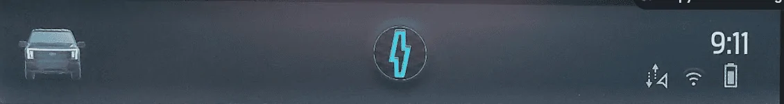

Pull the menu via the top center user profile icon.
Ford F-150 Lightning Unrequested traffic info being spoken 1671500548282

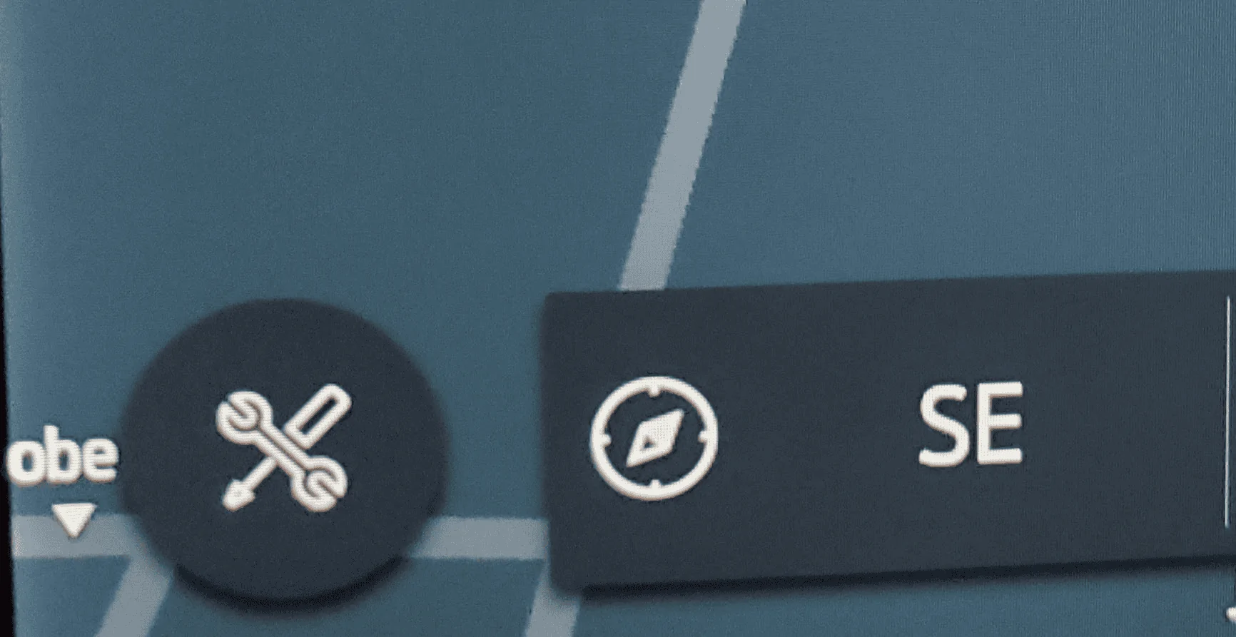

Tap Nav, then in the lower left corner of map screen tap the wrench icon

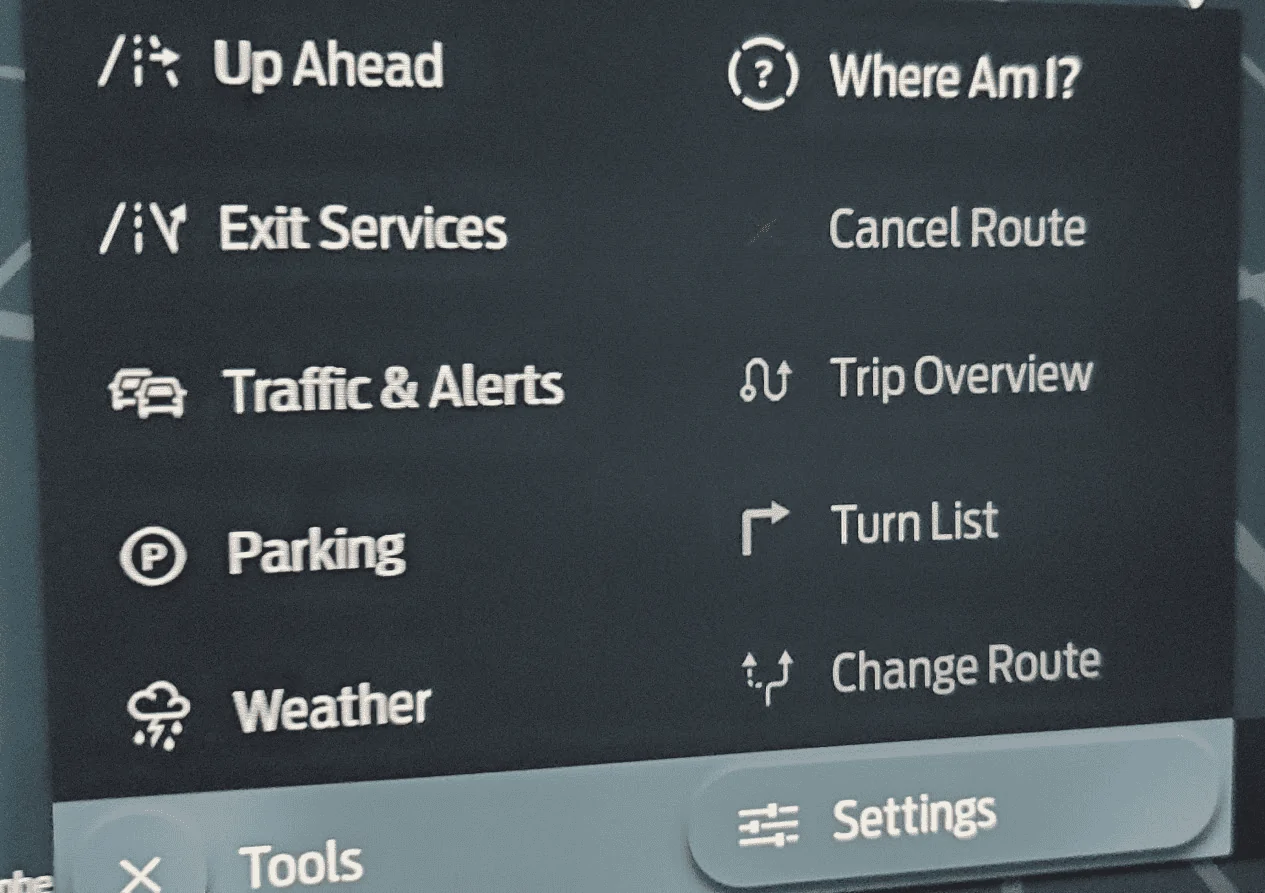

then tap settings on the lower bar just below "Change Route"
Explore all the options, one might be responsible for this activity.
