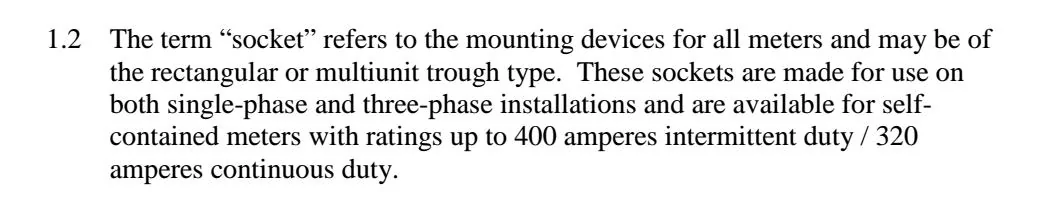

Here's where the 320 Amps is coming from. From my utility's documentation:
Looks like a 400A meter is only rated for 400A intermittently, but 320A continuously. Utilities do some weird cost-saving things regularly, like undersizing utility-owned transformers for new installations, etc. It's a black box for design and I guess they figure replacing a few blown pieces of equipment a year is better than properly sizing everything. ?
Ford F-150 Lightning Updated Ford Intelligent Backup Power page (no longer) details 320-Amp Home Service o_O Screenshot_20220113-101452_Office Mobil
EDIT: Actually, this is not dissimilar to the typical circuit loading design standards of 80%... for example the 80A EVSE from Ford requires a 100A circuit. 80% of 400A is 320A.
