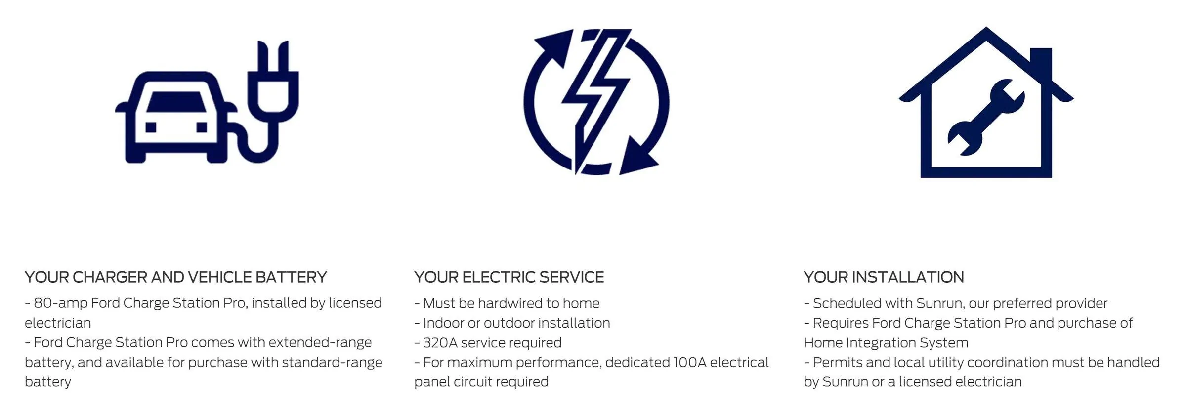

Based on recent updates to the Intelligent Backup page:
https://www.ford.com/trucks/f150/f150-lightning/2022/features/intelligent-backup-power/
About 1/3 of the way down the page a graphic states 320 Amp service is required! This seems like an odd number.
I totally get the 100 amp dedicated circuit for the 80-amp Charge Station Pro. That makes perfect sense. Your home has to have sufficient service to cover existing loads plus the new 80 amp charger. That also makes sense.
I wonder if many folks actually have 320 amp service already? (Not us, we've only got 150 amp service and suspected we might likely be looking at an upgrade anyway if we wanted to take full advantage of the 80 amp charger and run the rest of our house.)
Maybe I've missed it, but there aren't 320 amp mains panels that I've ever seen looking at the standard residential stuff on the DIY box store sites? Seems like a pretty odd requirement. Our provider (AEP) website has a request form to upgrade from 100/200/400 to 100/200/400 amp service. Assuming the 80% rule applies, looks like we might have to submit a request for some heavier 400 amp cable runs along with the upgraded meter base (and meter) to cover the 320 amp service requirement. I can't imagine that will be free.
The 320 amp service might either be fed by a 400 amp (non-continuous) meter base at 80%, or a 320 amp meter base with maybe two 150 amp panels somehow, though that doesn't seem quite right either. Maybe they're adding a 100 amp dedicated charger circuit along with the typical modern home's existing 150-200 amp service? Considering they ultimately plan to feed house loads with an inverter and transfer switch, not sure how that would all work with the 320 amp service, that's a hefty transfer switch. Maybe they're expecting to re-wire things a bit to feed a separate backed-up loads panel?
Any electricians out there that might have some insight? Hopefully we'll continue to see more and more information released on the IBP and "Home Integration Solution" as we get closer to deliveries. Unless I'm mistaken, Sunrun doesn't seem to produce products of their own, so they almost have to be using someone else's gear. Should also be fun since they're not in my state.
All of this will be interesting to see if (or how) nicely it will "play" with my home's existing solar back-end of a SolarEdge Backup Interface (whole home backup device with integrated transfer switch and optional standalone generator input) coupled with panels, Energy Hub Inverters and a LG RESU10H backup battery.
Guess I'll have to keep doing research on the Ford/Sunrun Home Integration platform. Are you in the same or a similar boat? Let's keep track of what we learn here!
Notice anything different?
Ford F-150 Lightning Updated Ford Intelligent Backup Power page (no longer) details 320-Amp Home Service o_O 1643231325807

Nice, they finally fixed their messaging there. As long as your panel can take the 80A charger you won't need to expand.
