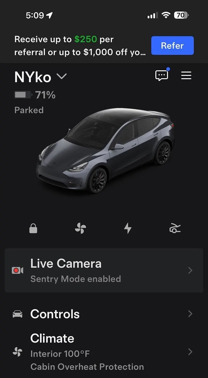

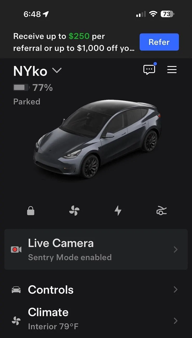

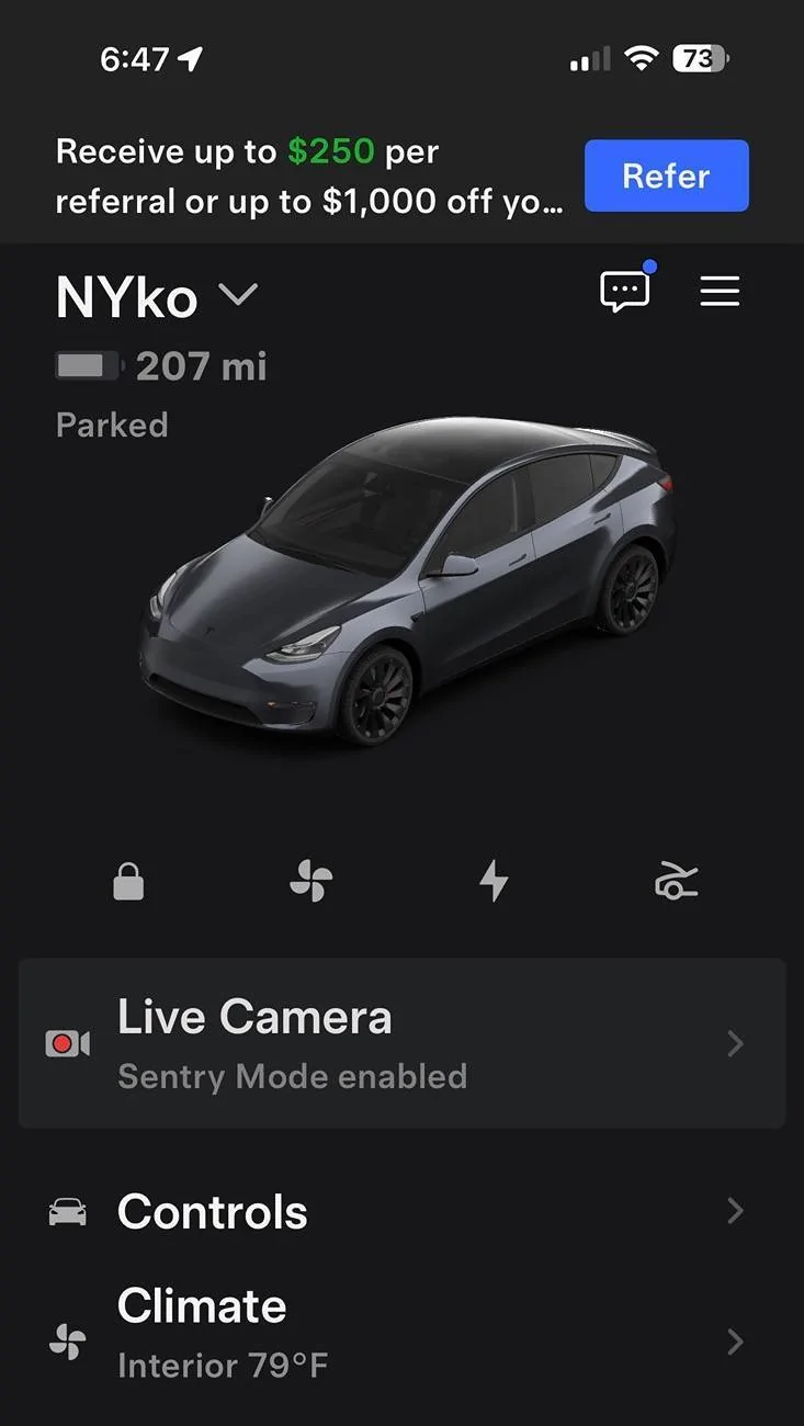

There is almost NO draw from a Tesla battery for Sentry mode. Real world proof.
2023 Performance Y (82 kWh battery) - June 30 in Dallas. 97 degree day. From before 7 AM to after 5 PM. Sentry and Cabin Overheat Protection were both on all day.
Two screen shots from morning - one showing HV SOC and then estimated miles. Then at end of day SOC and estimated miles.
Used 6% (4.92 kWh) of the HV battery which is an estimated 17 miles of range - 10 hours outdoor sitting on the pavement. Sentry mode may have consumed 1 kWh, but likely even only part of that. Cabin Overheat - AC running all day consumed the majority of that.
6:47 AM: first pic % and second showing miles (yep all you have to do is touch it in the App and it will change for you)
Ford F-150 Lightning Use 360 cameras for security. img_9056-jpeg
Ford F-150 Lightning Use 360 cameras for security. img_9055-jpeg
End of day 5:09 PM.
Ford F-150 Lightning Use 360 cameras for security. img_9058-jpeg
Ford F-150 Lightning Use 360 cameras for security. img_9057-jpeg

I've had 3 Tesla's and recently proven that there is little strain on the Tesla battery for Sentry mode. Most of it is likely from the Cabin Overheat Protection. You also have to remember the 3 and Y have batteries a fraction of the size of our trucks. So overall percentage would be even less. Sentry mode is worth it all day long, but you won't ever get it on the Lightning.
This fall when it cools down and Cabin overheat doesn't kick in, I'll get new numbers for Sentry mode alone.

I would not call 7-8kWh / day a "slight draw". That's what we've observed leaving sentry mode on while away from the house. Recent updates claim to have cut this down some, but we haven't re-checked it. Keeping most of the car on just to process and store images is very silly and wasteful....
Wow! 7-8 kwh that is a lot. I had no idea that system used that much energy. It wouldn't take long to drain your battery.
