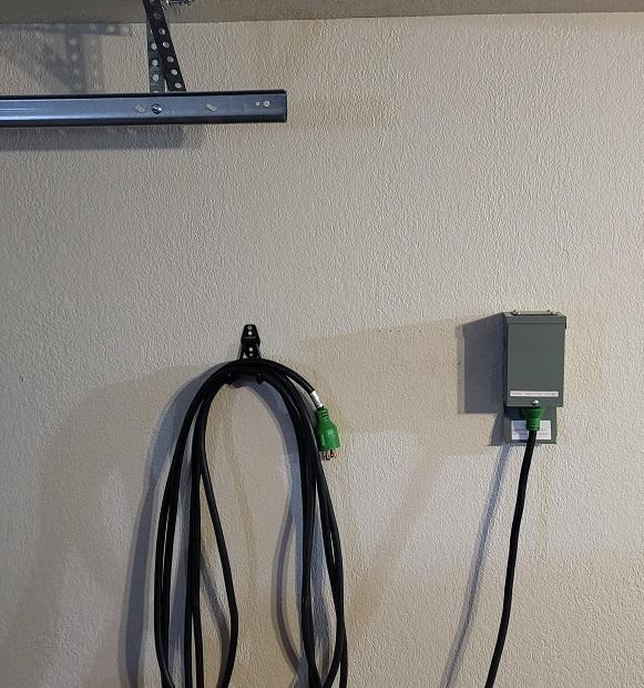

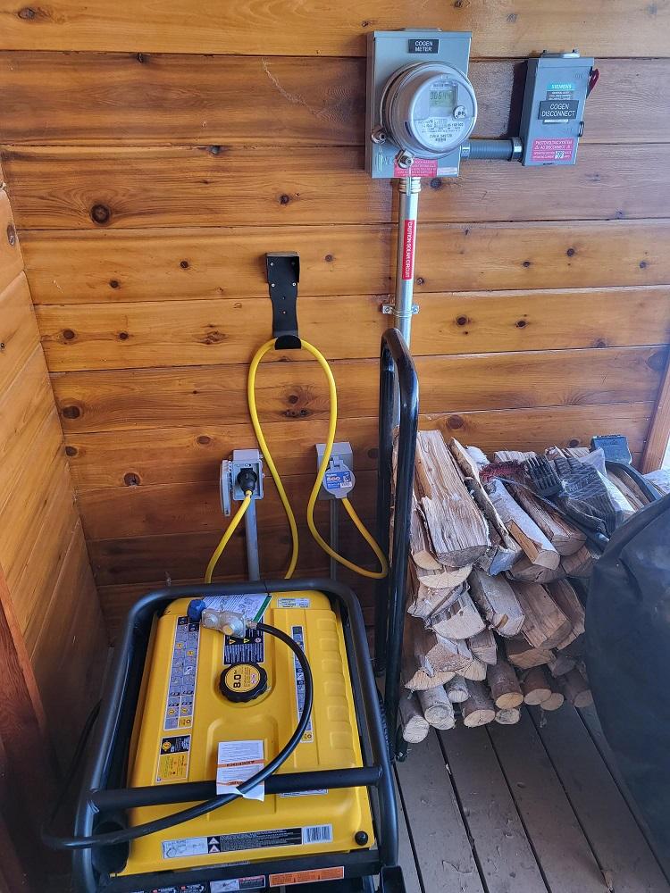

Yes, I have a grid-tied solar array with a hybrid Schneider inverter and controller, an LFP backup battery, and a 30A generator input that can be used to recharge the battery in the case of an extended outage. (The key to a system like this is that you will already have your critical circuits on a separate subpanel, so that you will not exceed the 30A output of the Lightning's Pro Power outlet in the bed.) The LFP battery backup option with the solar works great, by itself, for 2-6 hour outages (which are fairly common here). It is, however, a bit of a pain during extended outages when solar recharging is not available - especially if it's -40F and you are trying to start a cold-soaked generator.
My backup solution fits exactly what you are describing. To make it work without even having to go outside in the cold, I installed a 30A extension circuit that runs from an L15-30P outlet box inside my garage (Remember this is an input circuit that is always unpowered UNTIL it is plugged into the Lightning so the plug you see there isn't hot.)
Ford F-150 Lightning Using Lightning as a Generator Garage
to an L15-30R outlet next to the 30A generator input (L15-30P) on the deck. (Yes, you do need to disconnect the ground on the deck outlet to prevent the Lightning Pro Power from faulting.)
Ford F-150 Lightning Using Lightning as a Generator Deck
Normally, I always keep the garage output cord connected to the generator input. That saves me from having to go outside during an extended power outage. It also keeps debris, spider webs, etc. from getting in the outlets.

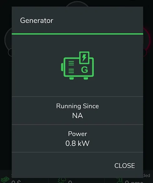

If the power goes out, my critical circuits are automatically powered for 2-6 hours by the LFP battery tied to the inverter,. If there is no (or too little) solar recharging, and my LFP battery starts to get low, I only need to manually turn on the 30A Pro Power outlet in the bed and plug in the 30A extension cable on the interior garage wall. Presto, the inverter see the Lightning's input power and treats it like the generator that it is. The image below is from the Schneider App with the Lightning providing power to the inverter. (The running time is blank because I did the screen capture before 1 minute had elapsed.)
Ford F-150 Lightning Using Lightning as a Generator Gen
If the power outage goes on for days (and the solar darkness continues) and the Lightning's battery gets low, you simply start your generator, unplug the extension cable from the garage output outlet on the deck then plug it into the generator's 30A L15-30R outlet. (If your generator fuel runs out, just accept that you are going to die - OR before running out of generator fuel, drive the Lightning to a charger with power, charge it up, then return home and start over.)
If your Lightning is parked close to your generator input, you may not need to install the 30A extension circuit I installed between my garage and the generator input on my deck. A simple pass thru port in your garage wall for an extension cord may work. I do prefer the added safety of a hard wired circuit as opposed to an extension cord laying on the ground.
