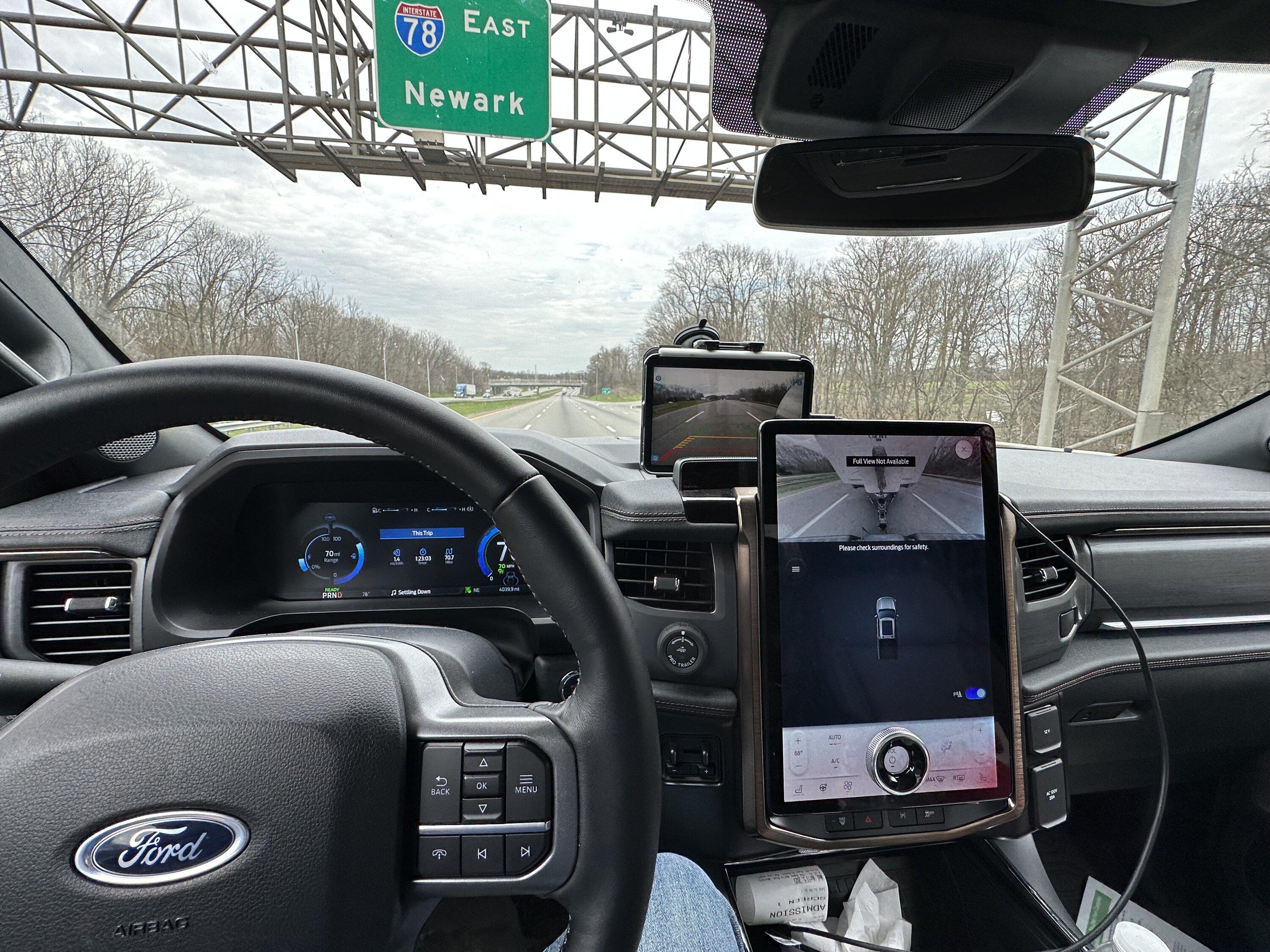

Attached is a picture of me towing my 25’ camper. It showed just about 100 miles of range when I hooked it up. 70 miles later, it showed 70 miles of range remaining. That’s fully configured and with history too, and its still conservative
You can even see I’ve got about 60-70% battery remaining despite the GoM indicating I should be closer to 50%.
