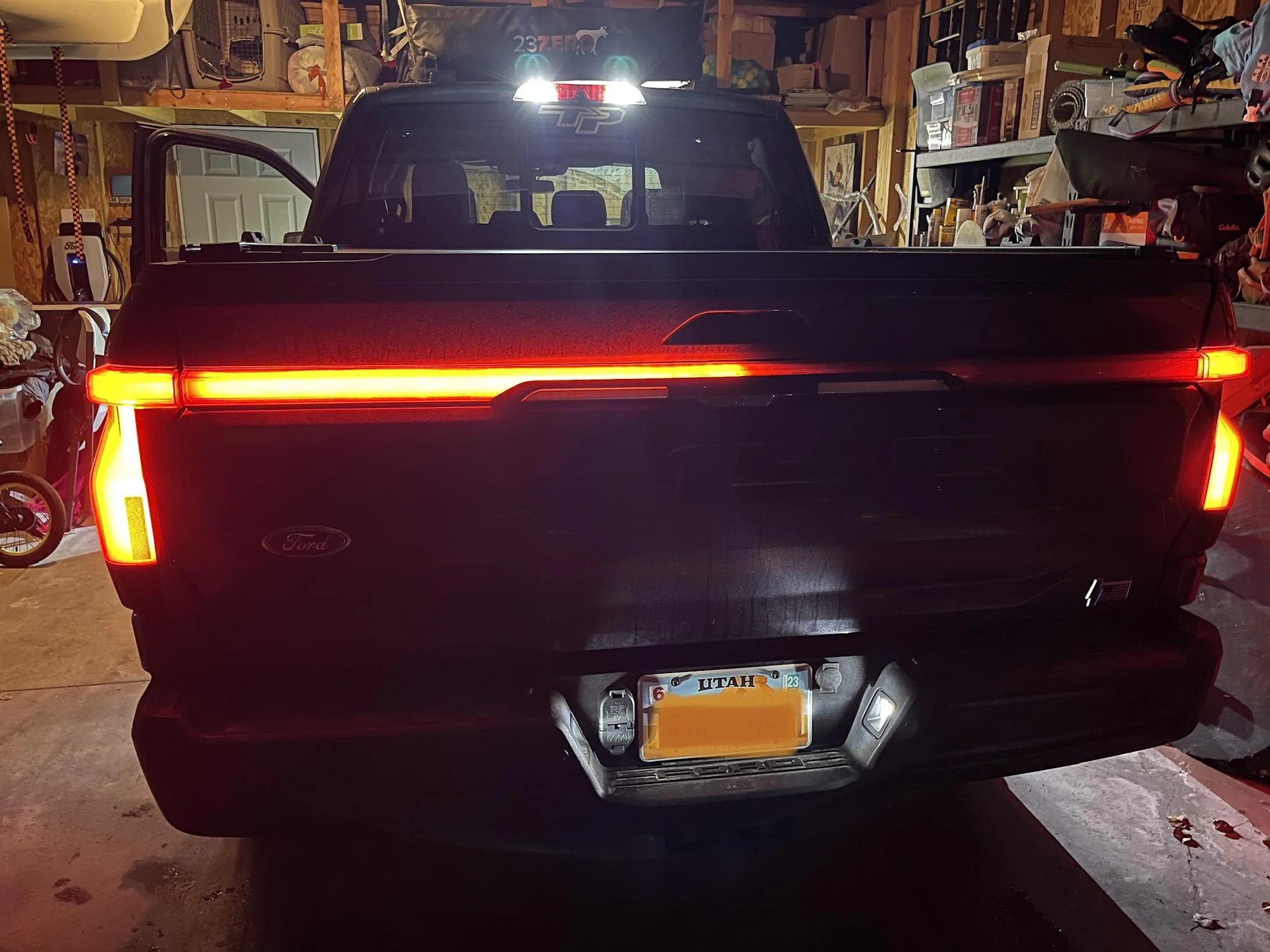

Well I'm glad I found this thread. Kinda. Had quite a few little problems that I was 'ignoring', one of them was annoying flickering of the white LED (reverse lights) and I thought I had a few drivers flash their brights at me on the freeway- probably because my red lights were flickering. When my buddy called me and told me to take a look at my tailgate, my frustration finally led me to call the dealer.
I'm not feeling great about this- just continually replacing it?! Affects basically all tailgate lighting and backup camera?! Ugh.

Welcome to the club. Sorry you are here though!
