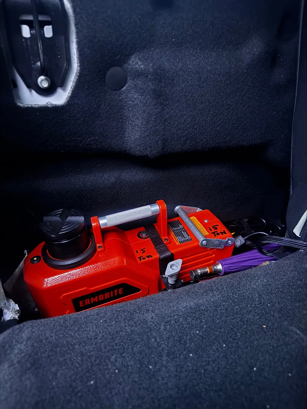

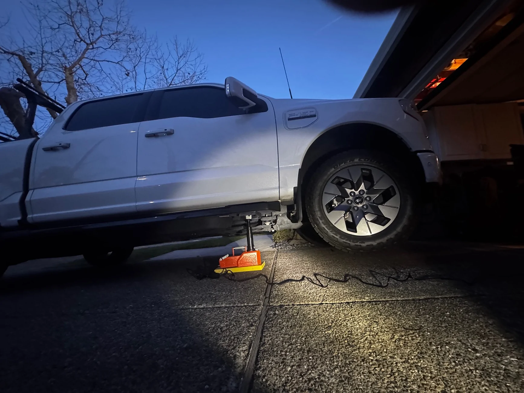

I use it with a 1 foot 2x8 on the ground. Works fine for flats. I was not intending for it to replace my floor jack. I could not find a 120V jack. Please let me know what your search finds. Here is a pic in use and stored behind the back seat passenger side.
