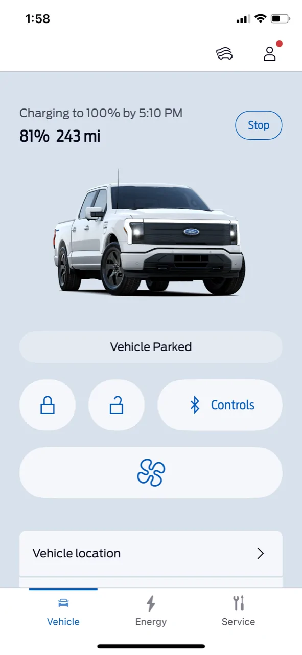

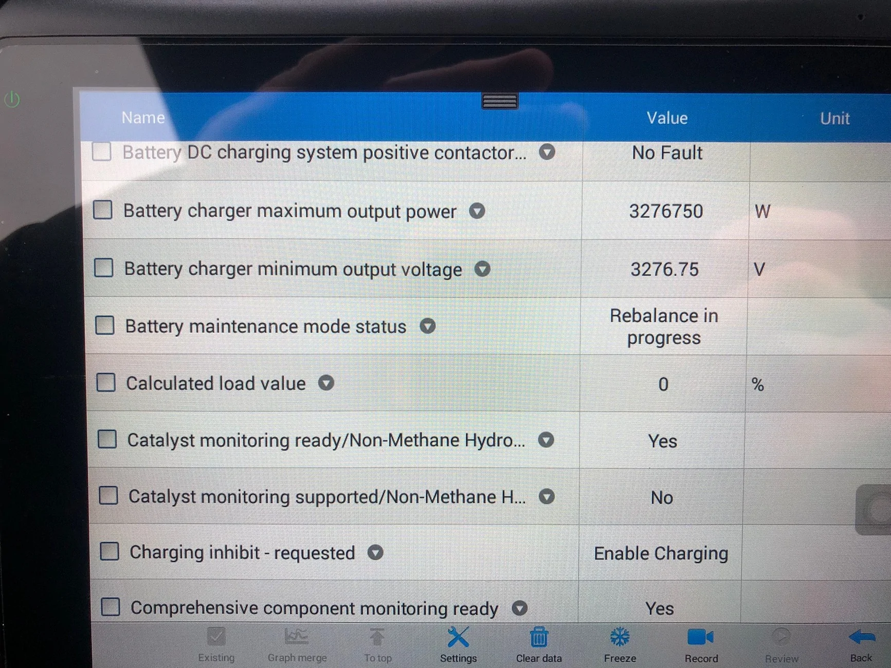

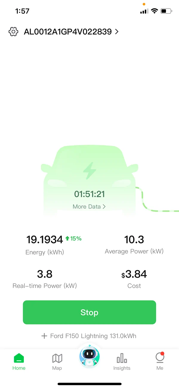

I did another test this morning. There is something definitely wrong. I set the charge to 100% on the app. I started at 73%. The initial charging rate was 12KW on my Autel charger. Once the truck hit 80%, the rate dipped to 3.8KW. I also used my autel scanner. It stated "rebalance in progress" in the battery maintenance mode status section. Why would it say that so long after the module installation?

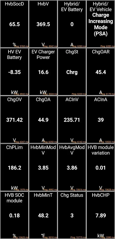

You can see it below listed as HVB Module Variation and HVB SOC Module

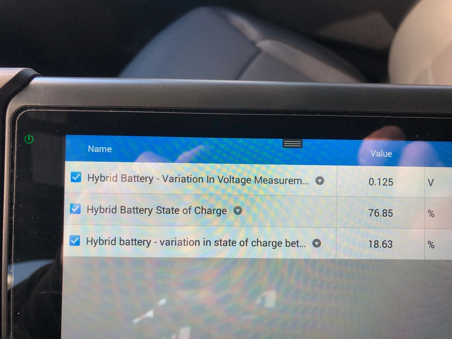

@PJnc284 I think I figured it out. I did not realize that my Autel has access to all of those parameters. Look at the state of charge percentage between modules. It is over 18%. I am assuming it is not supposed to be that high!

Yes, the variation is over 18.5%. Now it all makes sense to me. I know from past experience that during level 2 charging, the truck ramps down the current draw when it gets close to 100%. Now I can see why it is ramping it down (significantly) when it hits about 80%. It is basing the SOC on the highest module which is close to 20% higher than the other modules. Therefore, it ramps it down because the module with the highest charge is close to 100%. I just hope they fix it.
One has to suspect that @Ford Motor Company had specific limitations on imbalance and when it's absolutely required to invest shop time to get the value in the ballpark!!!
