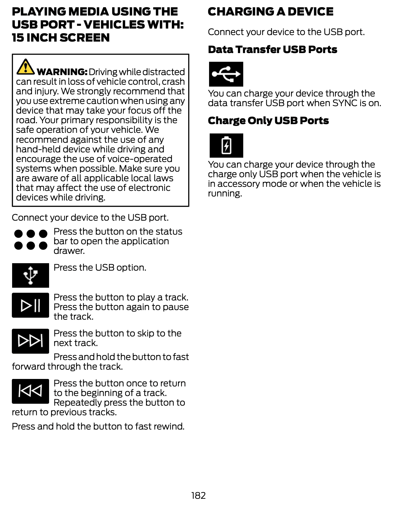

I brought a USB drive with a book to listen to on our trip. We just tried to play it and I can't find the option to do so. It looks like the ability to play music and/or audio books off a USB is either gone or well-hidden. I've dug through the app and control options and can't find it anywhere.
I checked the online manual and it basically says the same thing the print manual does:
Ford F-150 Lightning Where did the USB media go in the new User Interface (UI)? (Solved - sort of) Screenshot 2023-02-03 at 3.36.29 PM
Has anyone figured out where they moved this feature since PowerUp 4.1.2?

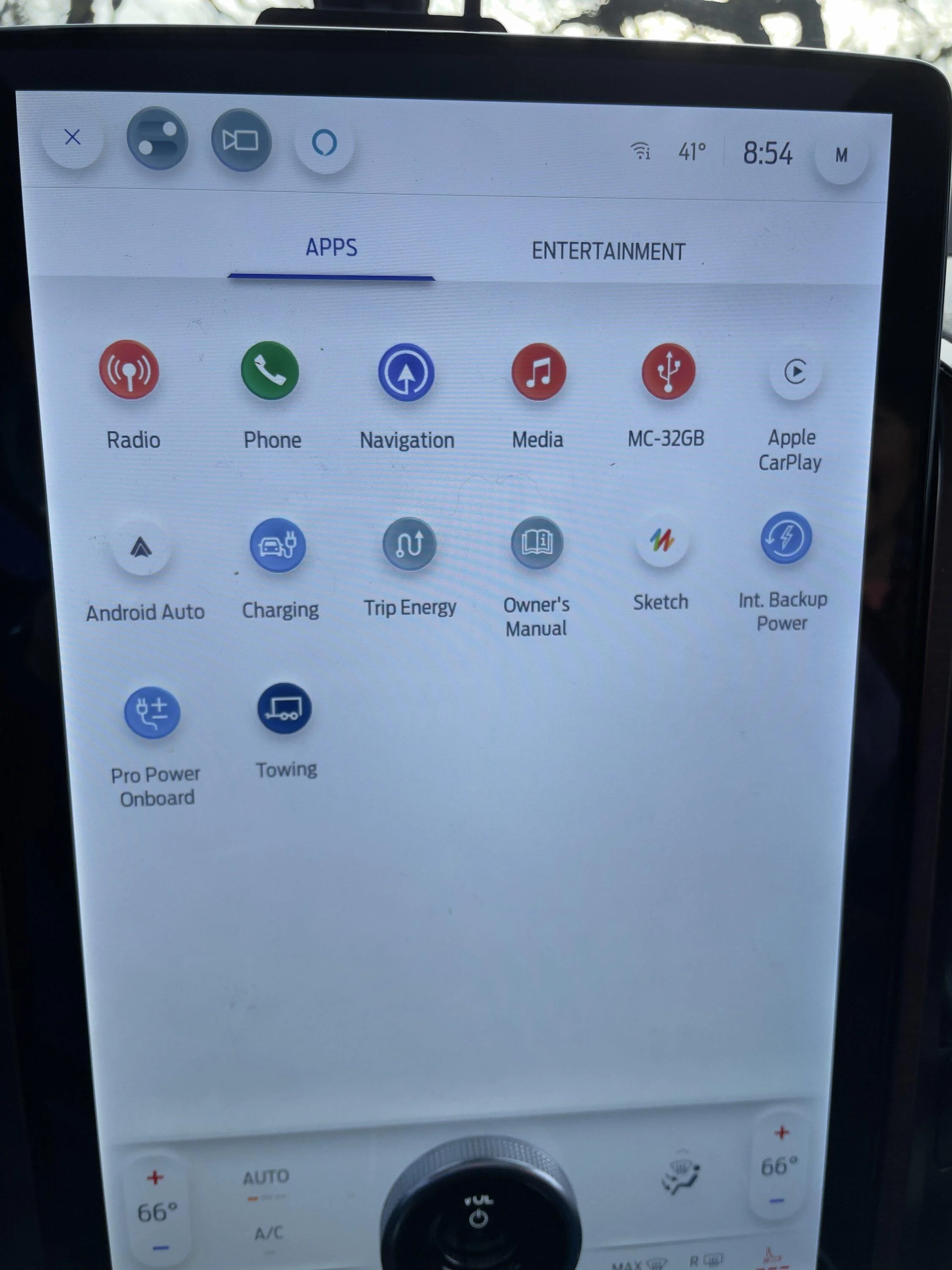

Works for me and is just where the manual says. I would note that it does not say USB but rather has the name of your USB drive. So if your drive is labelled MyBooks, it will show up as the MyBooks app, see my screenshot. My USB has the label 16GB USB. I am on 4.1.3.

OK, never mind. This morning when I started the truck the USB was there (MC-32GB). I had done nothing all but stop the truck for the night. Classic. We're listening to the book now.
