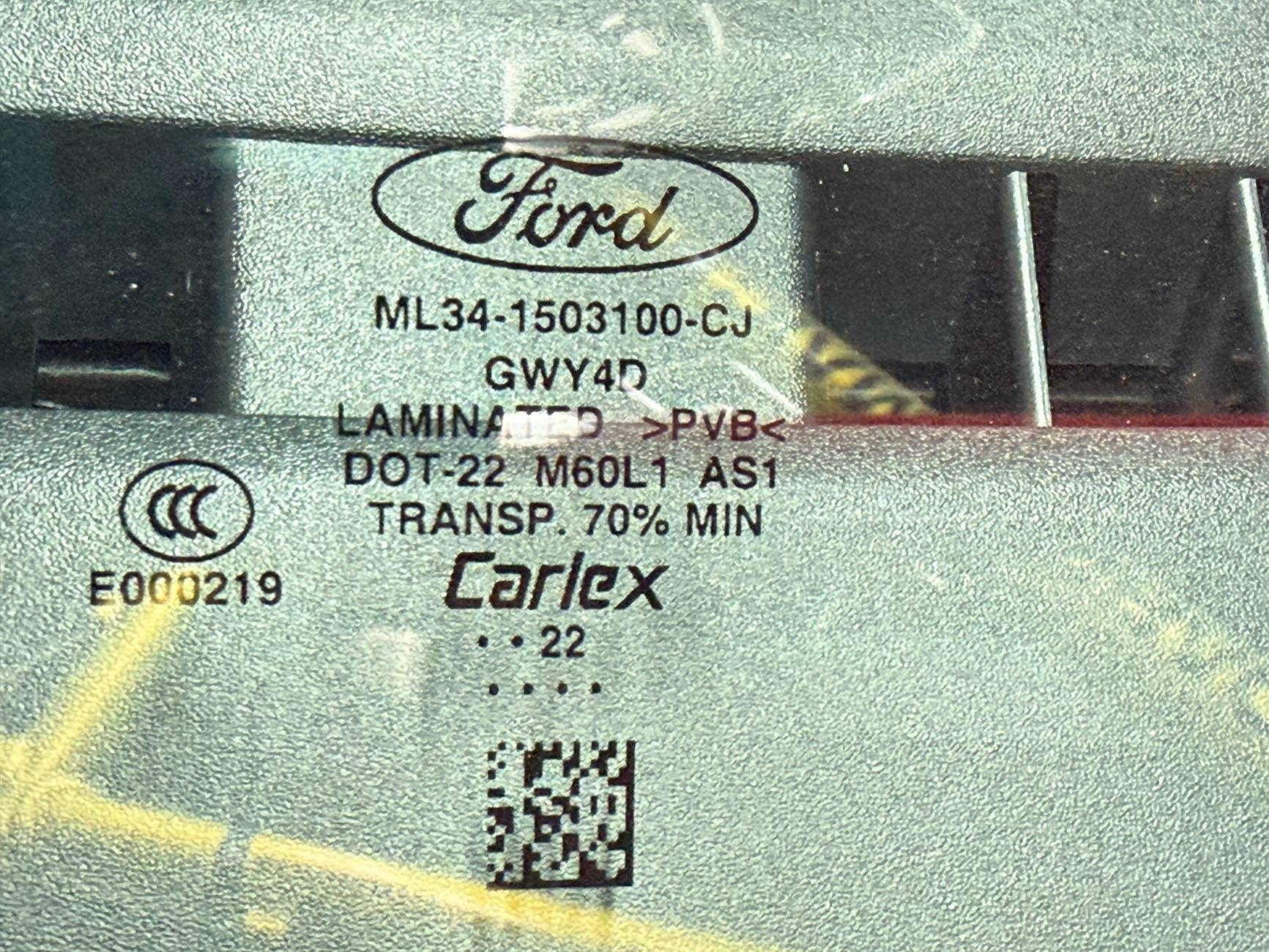

Great information - thank you. I had looked in all 4 corners of the glass for info, but had not looked in the center of the glass. All the info just as you noted and Carlex has the matching engineering numbers cross referenced to part numbers. Surprised at the price even from the Ford parts guys - $450 - $600 depending on which site you go to. Cheaper than I expected.
For future reference and anyone else searching - this is the part number and printed info from a '22 Lariat with auto wipers and BC.
Part number - ML3Z 1503100 J
Ford F-150 Lightning Windshield replaced? IMG_7192
I'll have to confirm tomorrow if this is really the glass they have.

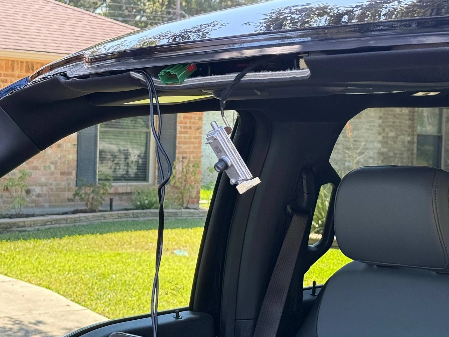

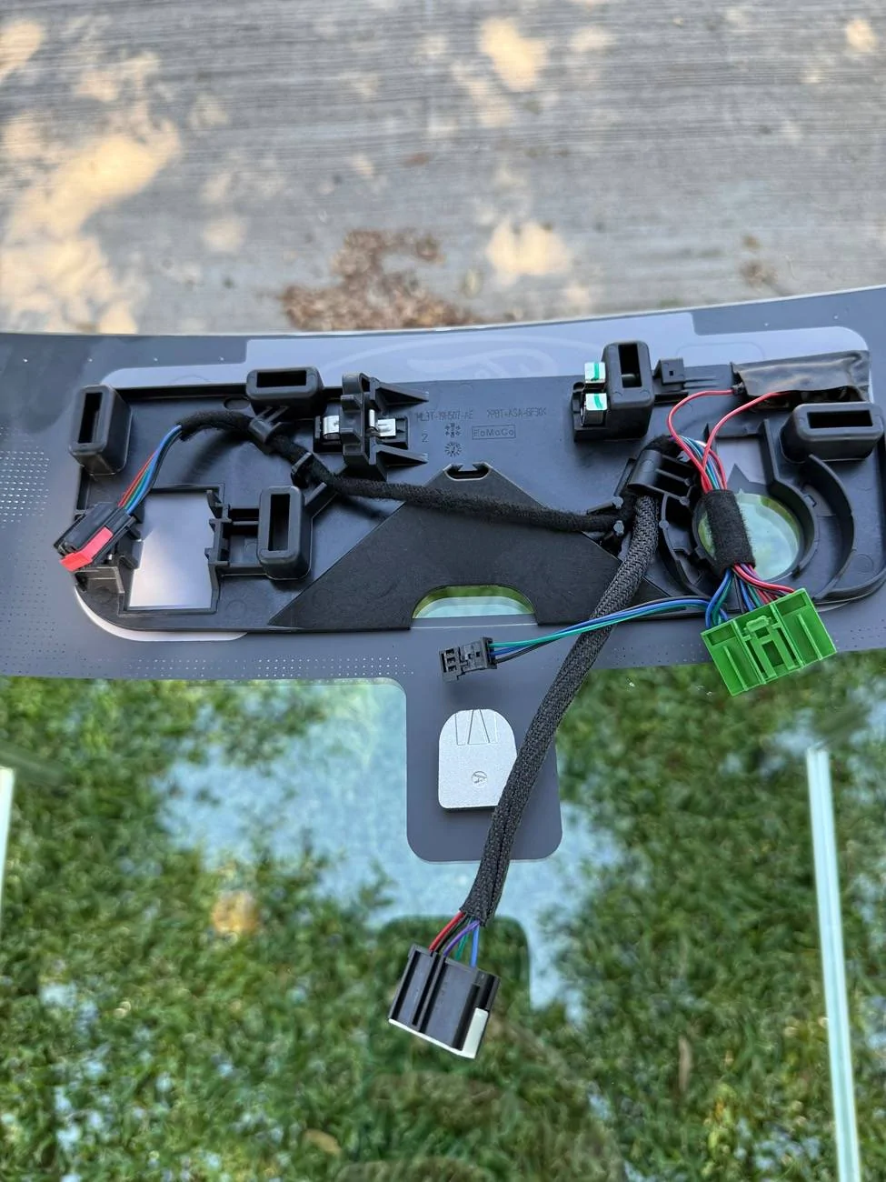

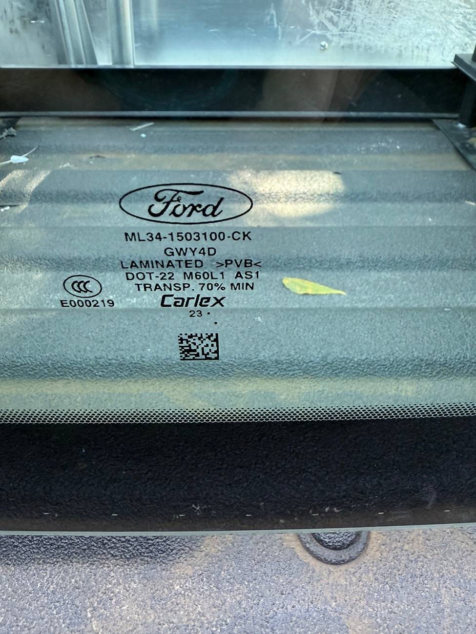

Follow up - DFW area I'm very pleased with Texas Star Automotive in McKinney - 972-452-7755. They listened and put in Ford original glass. State Farm insurance.
For a little documentation the engineering code on the new glass was one letter incremented on the end, so I assume some improvements or change of sorts in the last 2 years. The plastic mount for the cameras, BC equipment, rain sensors, etc comes attached to the new windshield with some wiring components. Then just has a plug or two from the truck.

Is that rust on the wiper drive assembly?

It does look like it a bit on the ball joints. I didn't pay a lot of attention as I was just snapping a pic and trying to stay out of the way of the installers.

Thanks. I’ll have to keep an eye on mine. I keep vehicles for a long time so I am always trying to figure out what to keep an eye out for.
