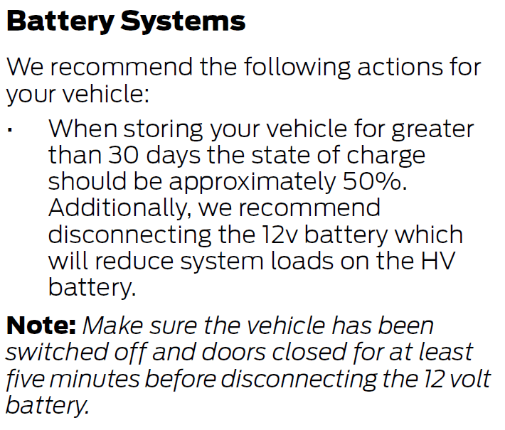

Not sure where or why you got 90%, but NO! Ford recommends storing at 50% SOC and set max charge to 50%, and disconnecting 12V battery.
Agreed. Thought I edited that out before posting the rest. Fixing it now.

If the 12V battery is entirely disconnected, will the vehicle actually charge?

Do not disconnect the 12v battery if leaving the vehicle plugged in. That's nonsensical since 12v modules might be needed occasionally if other HV modules are active. That's not what Ford is suggesting. They're suggesting just leaving it at 50% and unplugging the 12v battery. In other words, not connected to the EV charger either. I would do either - plugged in to EV charger and leave 12v battery connected, or disconnect EV charger and 12v battery. The HV battery will be fine for a couple months at 50%.

No where does it say to leave it plugged in. It says to get the battery to around 50%, and disconnect the 12v. Do NOT leave it plugged in.
Agreed. IMO, those instructions consider “Stored” as not plugged in. None of the storage facilities around here will have power available for this kind of use.
If plugging in is available, I think that’s a better option. Set to 50% and don’t disconnect anything. This is especially good for the HVB if subject to temperature extremes.
