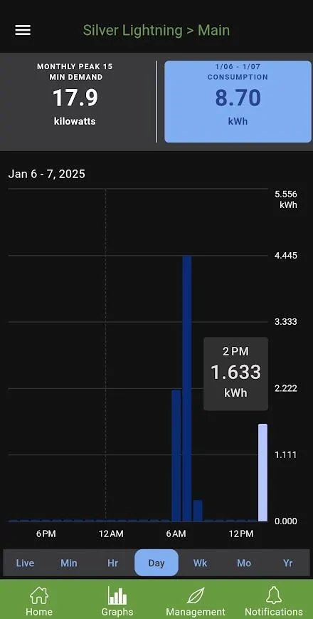

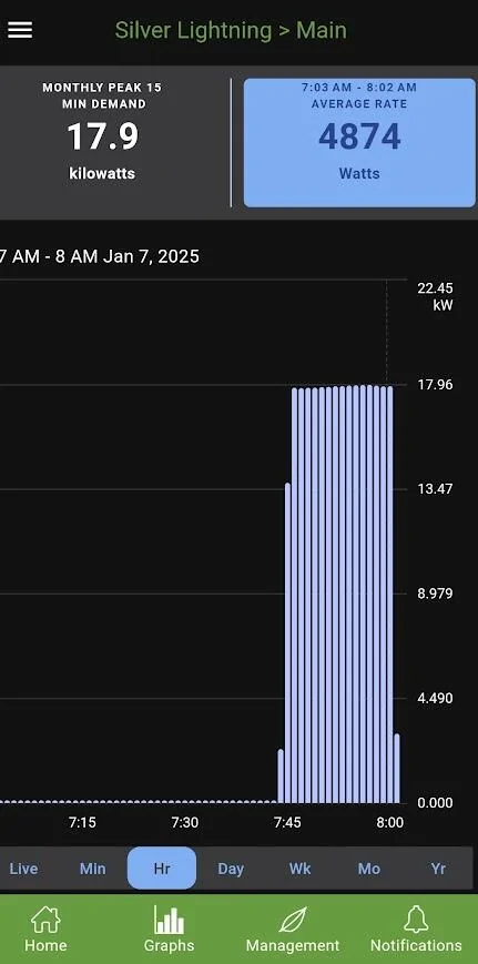

My truck was still showing 100% available power to the motors as of last evening, the heat created during the prior nights Sunday evening charging session was still useful to pack health.
Then Monday evening into Tuesday the temp's plummeted, and likely just enough heat was lost to trigger the BMS to call for a quick round of warming.
Since unplugging and starting our daily rounds, the warning to plug in when placed in park has not shown yet and might not until the pack temperature drops low enough, at this moment it is 22 outside.
Adding more information about the remote start energy used this morning:
4.5 kWh of additional energy sent to the PTC and slight charging to the HVB for 16 minutes

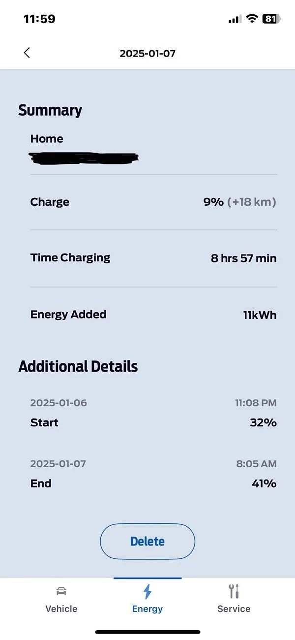

FordPass details so looks like net into battery? Not sure if that’s pre or post losses.

Thanks for the feedback. Assuming this was a ER truck, the SOC increased 9% (11 kWh) in 9 hours on 120volts at -25C (-13F).
Do you have any idea how much power that truck consumed? I am surprised with this result.
If it was a 20 amp circuit at 120 volts, it would be about 2.4 kw/hour, so 8 hours about 19 kWh in theory.
Some of that losses, some into heating the battery? Either way, IF my math is right, for those posters who only have 120v to charge in cold weather (-13F), this should be very encouraging.

With AC charging you are seeing the net energy deposited to the HVB, these numbers are in line with an ER pack {131 x 0.08 = 10.48 or as rounded up by Fordpass to 11 kWh}
I've seen AC/DC conversion losses at a minimum of 9% to as high as 25% in the winter depending on the temperature state of the battery, so gross input from the EVSE could range from 12kWK to 15 kWh.

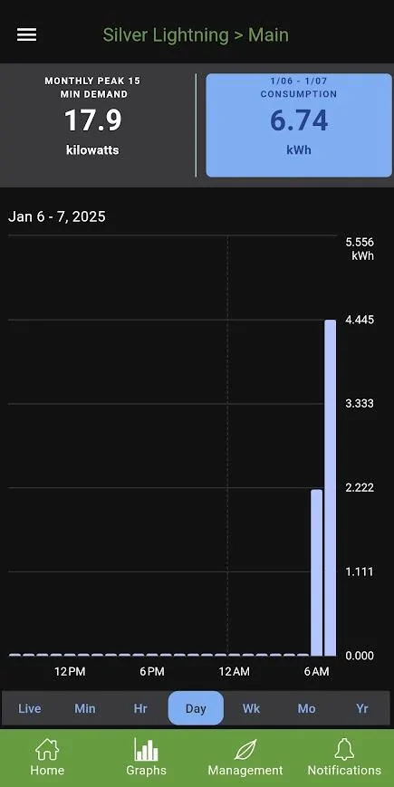

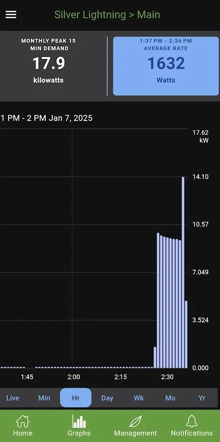

I just plugged in my truck after the days travels being done, it sat out in the cold morning through afternoon, we made a couple of afternoon stops, no additional charging or plug in during the middle of the day. The motor energy was starting to be limited to 95% at 80% SOC, after the the travels were done it was 95% at 77% SOC.
Upon plugging in, the BMS immediately demanded current from the FCSP, I heard the circulator pump start, and it continued for 11 minutes, pulling 1.63 kWh to touch up the battery temperature.
NOTE: this is only conditioning energy, the charger limit is set for 50% to suppress charging until the end of the week, I want to get a firm idea of what the daily / weekly energy demand is to keep the battery at optimum performance.

On 120V, the truck will never draw higher than 12A (1.4 KW input) regardless of the branch circuit rating.

It seems remarkable that 9 hours on 120v at -13 F provided 11 kWh into the HVB.

That 1.2KW to the battery with 1.4KW input. Not unreasonable.
