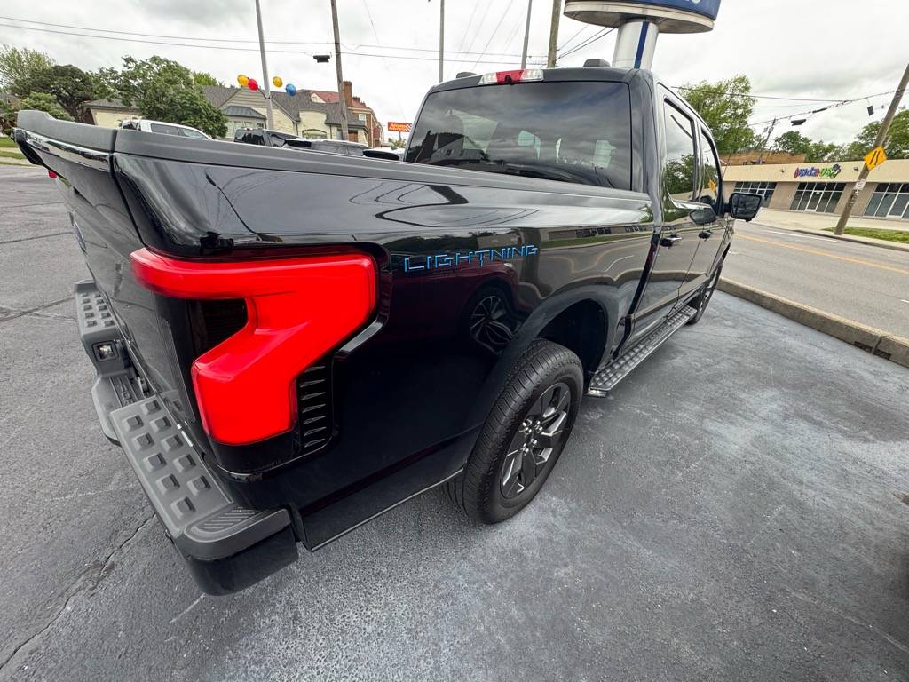

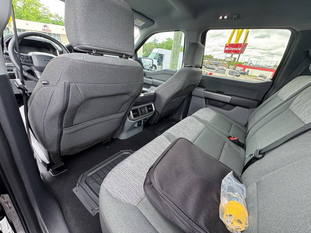

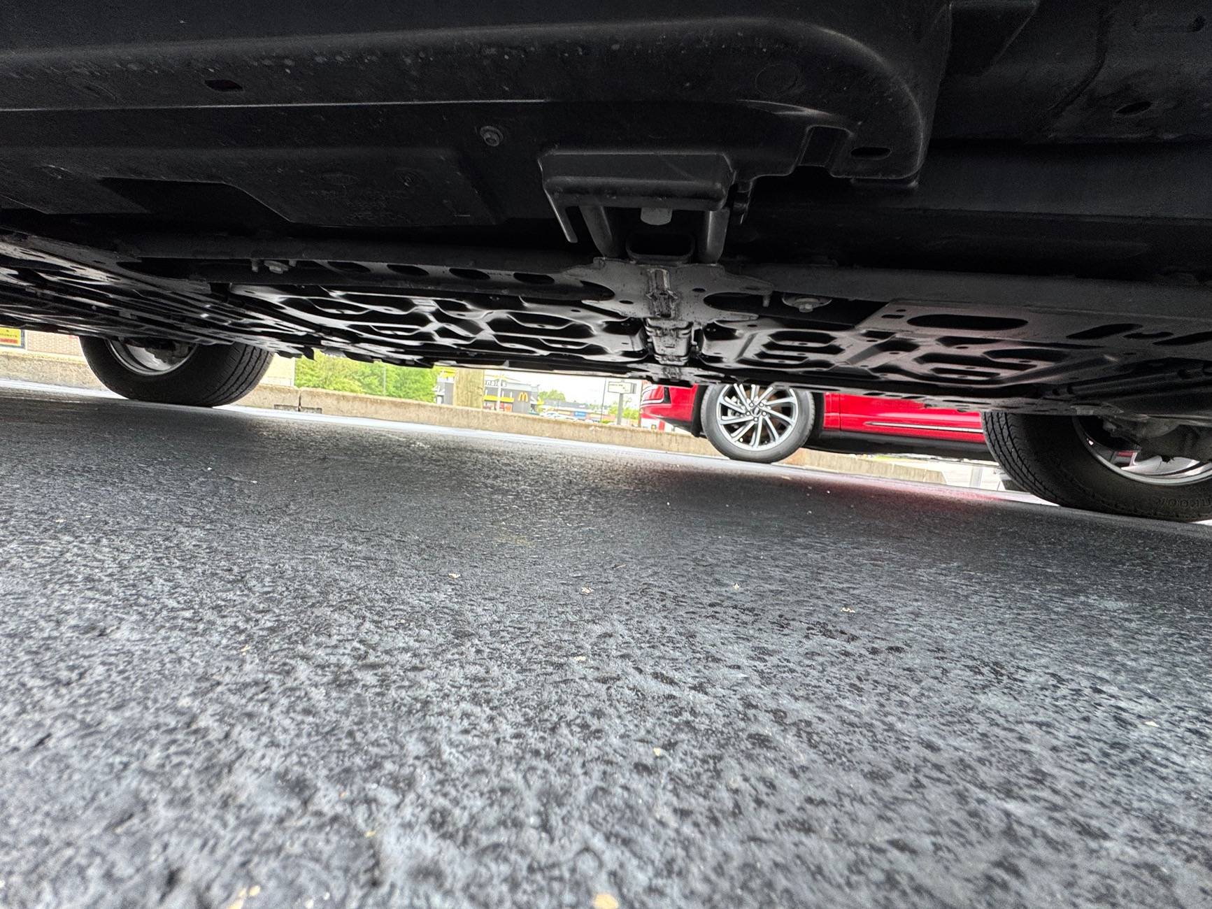

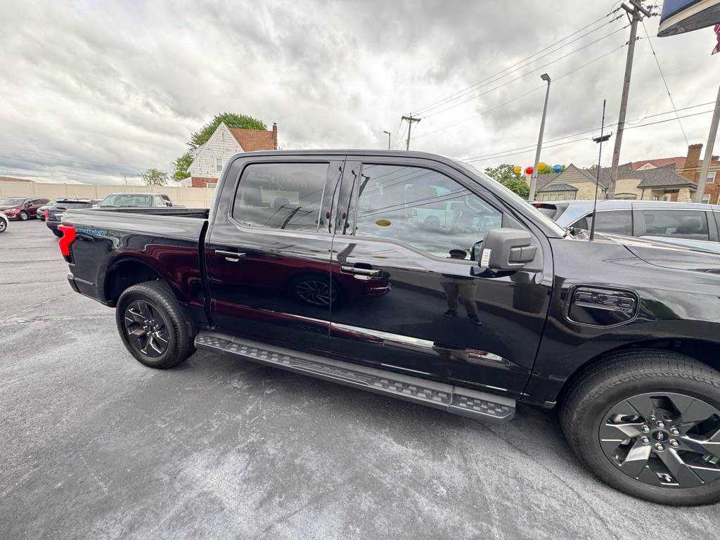

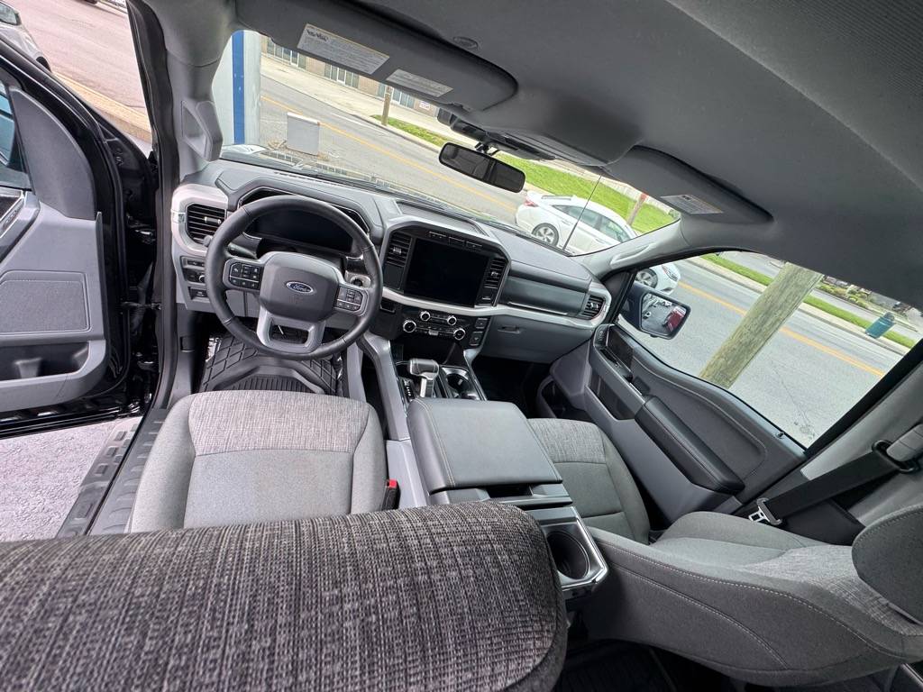

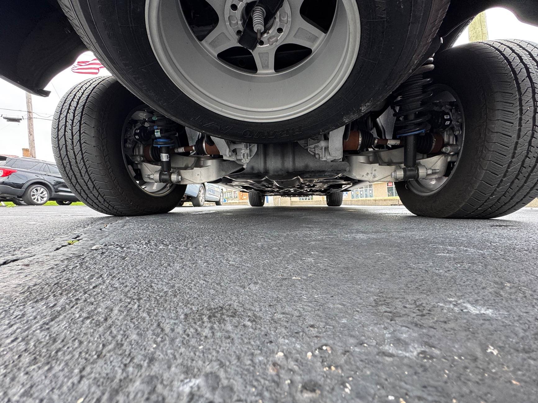

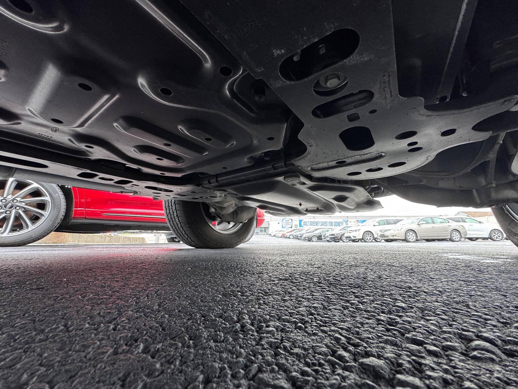

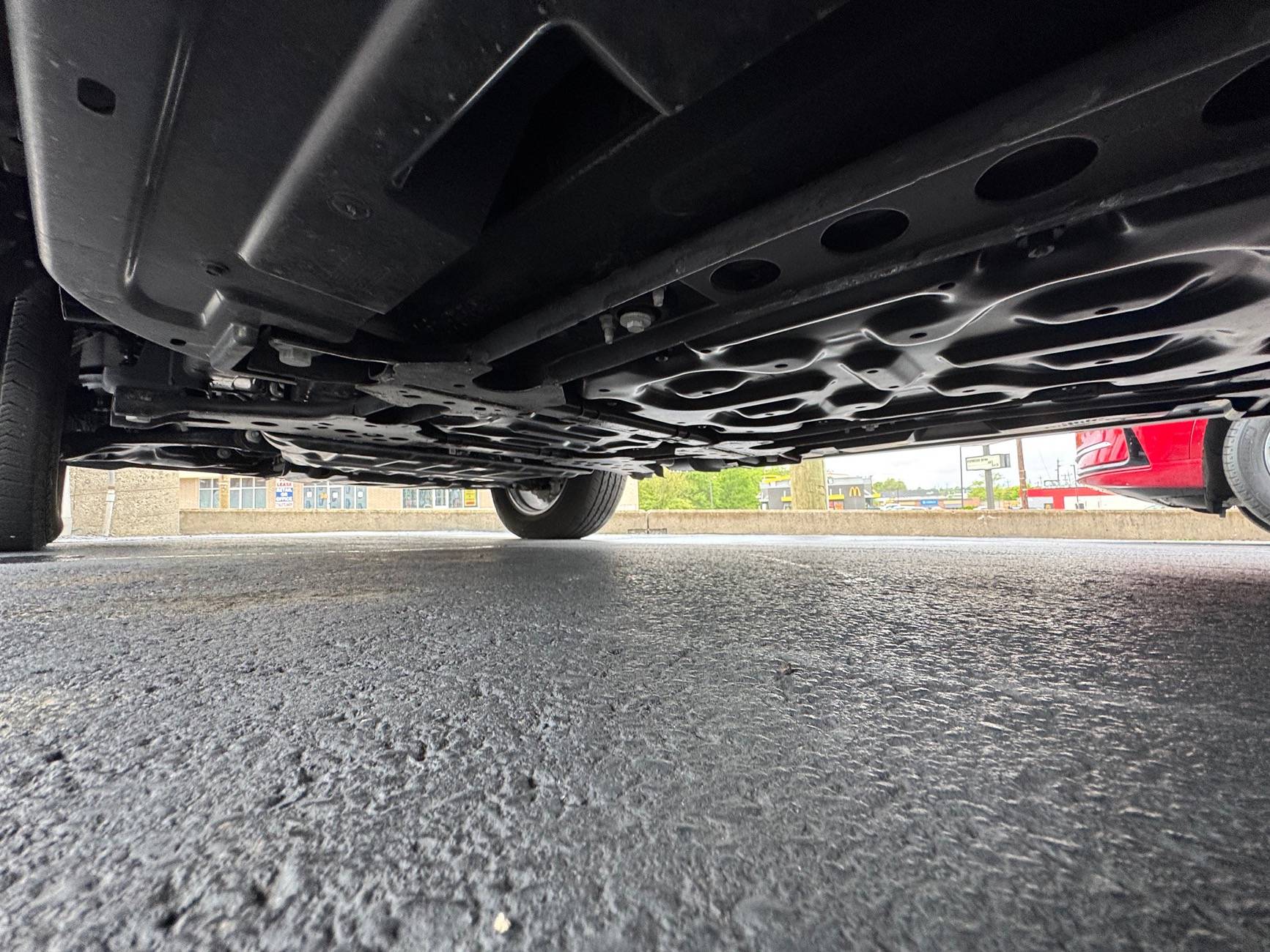

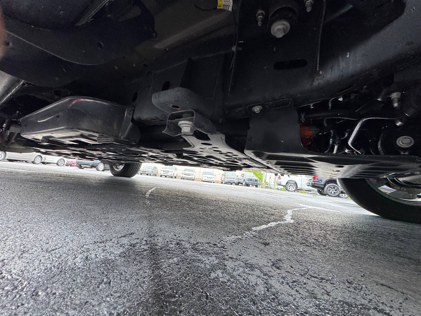

I have the remaining factory bumper to bumperwarranty till January 2027 or 36k (truck currently has 9k miles) and all the other remaining factory warranties remain, EV battery 8/100k. I’m also going to purchase an extended warranty from the ford to take the truck to 2032 with 60k miles (I drive on avg about 7k miles annually). The dealer has been transparent, sent videos driving it, undercarriage photos, insides outside photos etc. it was bought back by ford and repaired by ford with the factory warranty in tact still, which is why I’m considering it.
Looks like you are taking the right steps to complete this purchase ??
Just report back with pictures :)
